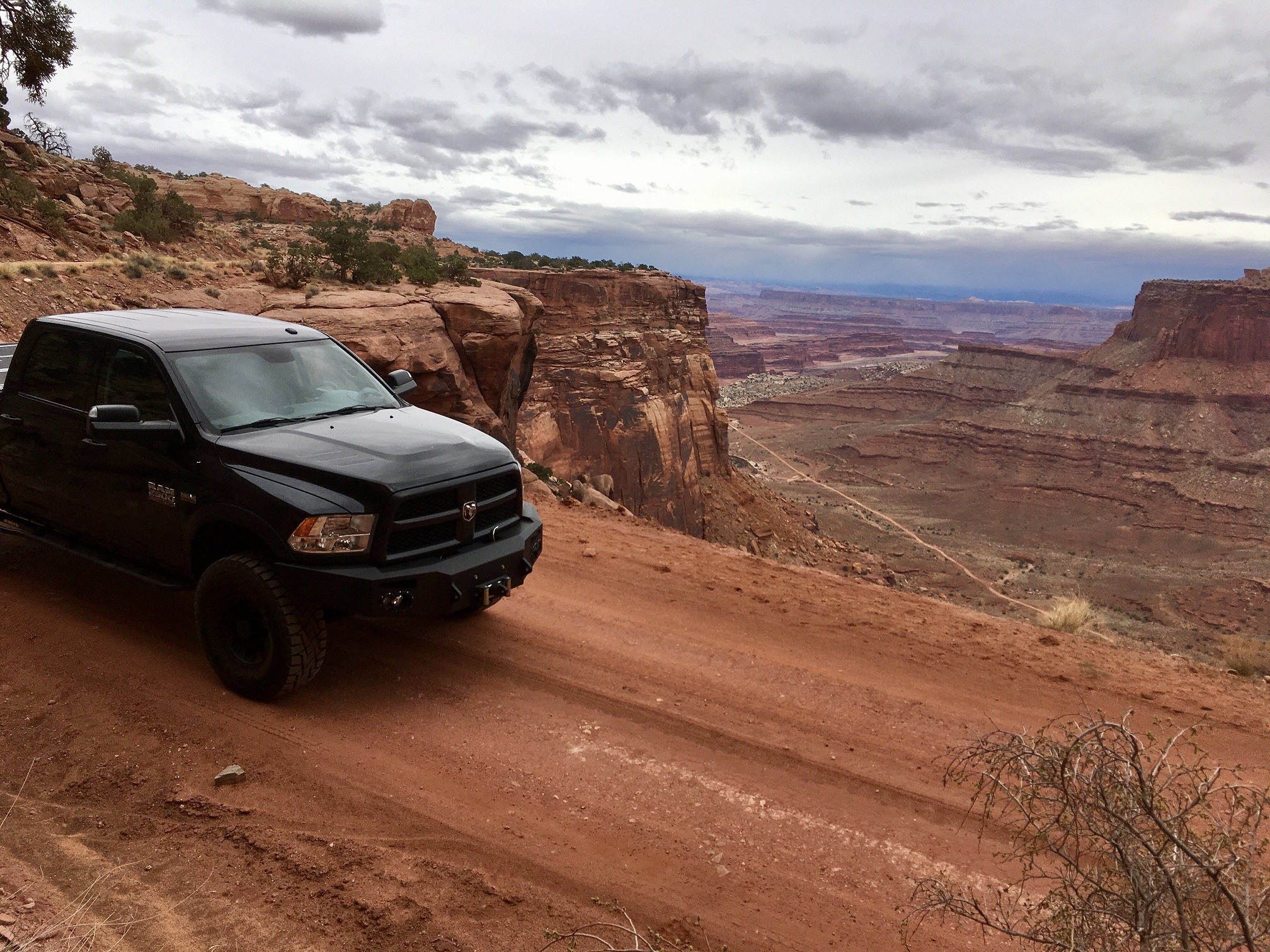

I have seen several threads that discuss axle ratio, but they seem to get convoluted quickly. I have done the math, and I need to be at 4.56 axle ratio for my towing application of a 8,800lb camping trailer (pictured below). The OEM 4.10 is too high, and my transmission goes over 200 degrees during heavy use. I have a real straightforward question. Does anybody have a good experience upgrading to 4.56 in a newer generation Power Wagon (2015 in my case)? Is anybody familiar with a good brand to go with for a 4.56 R&P kit? I am currently talking it through with a local 4 wheel parts, and their G2 axles representative. They can do it, but it feels like a lot of discussion on spacers and shims, and even a GM gear set instead of a Chrysler. In other words a total custom set-up. I am looking for near stock dependability and reliability. I want to avoid the loud noises, and reliability horror stories that I've read about. But, I cant find a manufacturer with a clean packaged set-up that gets you to a 4.56 axle ratio. Also I added some recent Moab pictures to soften the blow of all the nerd talk. Thank you for your feedback.
AEV Lift kit handles significantly better then stock. But, the 4.10 axle ratio is too high for 37" tires.
Canyonlands - MOAB
Canyonlands - Moab
Little Canyon Trail...I believe (Moab, UT)
