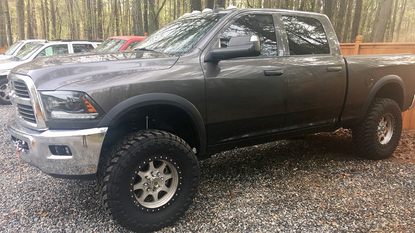

Off-road shop just sent me this pic... Thuren parts installed...

14PowerWaggy wrote:Off-road shop just sent me this pic... Thuren parts installed...
Looooookin good! What parts?

Re: 2015 Front Spring/Shock Swap
Looks great!!114PowerWaggy wrote:Off-road shop just sent me this pic... Thuren parts installed...
Thanks... Front overland kit and rear track bar... Going to see what I think then might add rear overland kit... when my kids quit spending all my money I'd like some Kings...olyelr wrote:14PowerWaggy wrote:Off-road shop just sent me this pic... Thuren parts installed...
Thank you...2011TXPowerWagon wrote:Looks great!!114PowerWaggy wrote:Off-road shop just sent me this pic... Thuren parts installed...
Truck Looks Awesome !!!!! Let me know what you think of the Read Track Bar Kit. Thinking of adding it next! Heard good things about it.14PowerWaggy wrote:Thanks... Front overland kit and rear track bar... Going to see what I think then might add rear overland kit... when my kids quit spending all my money I'd like some Kings...olyelr wrote:14PowerWaggy wrote:Off-road shop just sent me this pic... Thuren parts installed...

Picked up truck today and put about 80 miles on it, highway and city... What a difference over stock.. ride and height... rear track bar makes the truck feel more planted... worth the upgrade in my opinion...
You have one of the nicest, well rounded truck's on this forum. I'm pretty jealous of your wheel/tire combo.
