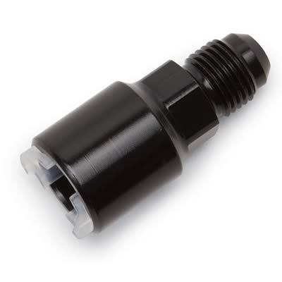

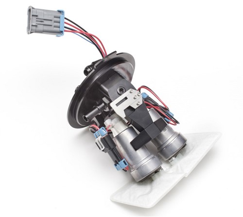

I've looked into doing this myself, the cleanest method I've come across is using a -AN to pushlock adapter either at the tank or the fuel rail and plumbing an inline filter between the stock line/components or if you want to go completely overboard do an aftermarket fuel system from fore innovation, starting with dual pumps in the oem position and run forward with -AN hose and billet fuel rails etc.
- -AN to factory style connection
