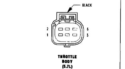

Yeah im afraid the TB took a dump, but truck works fine for a few km's then it happens. Turn it off and back on and good to go. Im looking into finding the actual pinout diagram at the pcm to run the diagnostic sequence BLM posted which comes up everytime i search from different sources. Anyway problem is they instruct you to probe terminals in accordance with the layout of the "miller special tool 8815" aka 250 wire harness that is not laid out like the factory plug. Pulled the TB and im quite upset at the fact that you cant even pull the stupid cover off to see the mecanism and internal wiring as im pretty sure its just something minor that wore out in there... either way ive always despised that ridiculous electronic throttle non sense what the hell was wrong with a good old cable setup? My truck should still work fine. Might be time to cut the bullshit and do that cummins 12v swap ive been dreaming about.

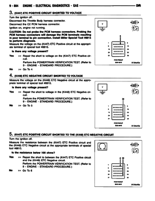

- Posts: 1210
Re: Limp mode! Wtf help needed
The introduction of electronic throttle was paving the way for future traction control nannies in the fourth gen. It's probably a shorted commutator or worn out brushes on the little electric motor. I'll try to take some screen shots of the FSM so you have some more diag. info.
- Posts: 1210
This is all the diag. info for code P2118.
Remember that pin locations and wire colors may be different on your 2006 compared to the 2008 FSM.

So i had a big ol reply typed about all this this morning but it wouldn't let me post it, anyway boiled down to how i still needed to find the actual pin location on the connector as the fsm tells you locations with the stupid tool 8815 and its nowherre near the same layout but i was going to look into it more andmaybe try to find said tool localy. That didnt happen but i cleaned the shit out of my TB and re-installed it. And that seem to have done it... im not ready to call it fixed yet but took the truck on a 12 km test drive then went out in town to run some errands and all is good. First step of the troubleshooting procedure is check for sticking throttle blade. To me it didnt seem like it was but maybe it really does not take much and the blade was sticking in the black TB gunk. I'll report back in a few days.
