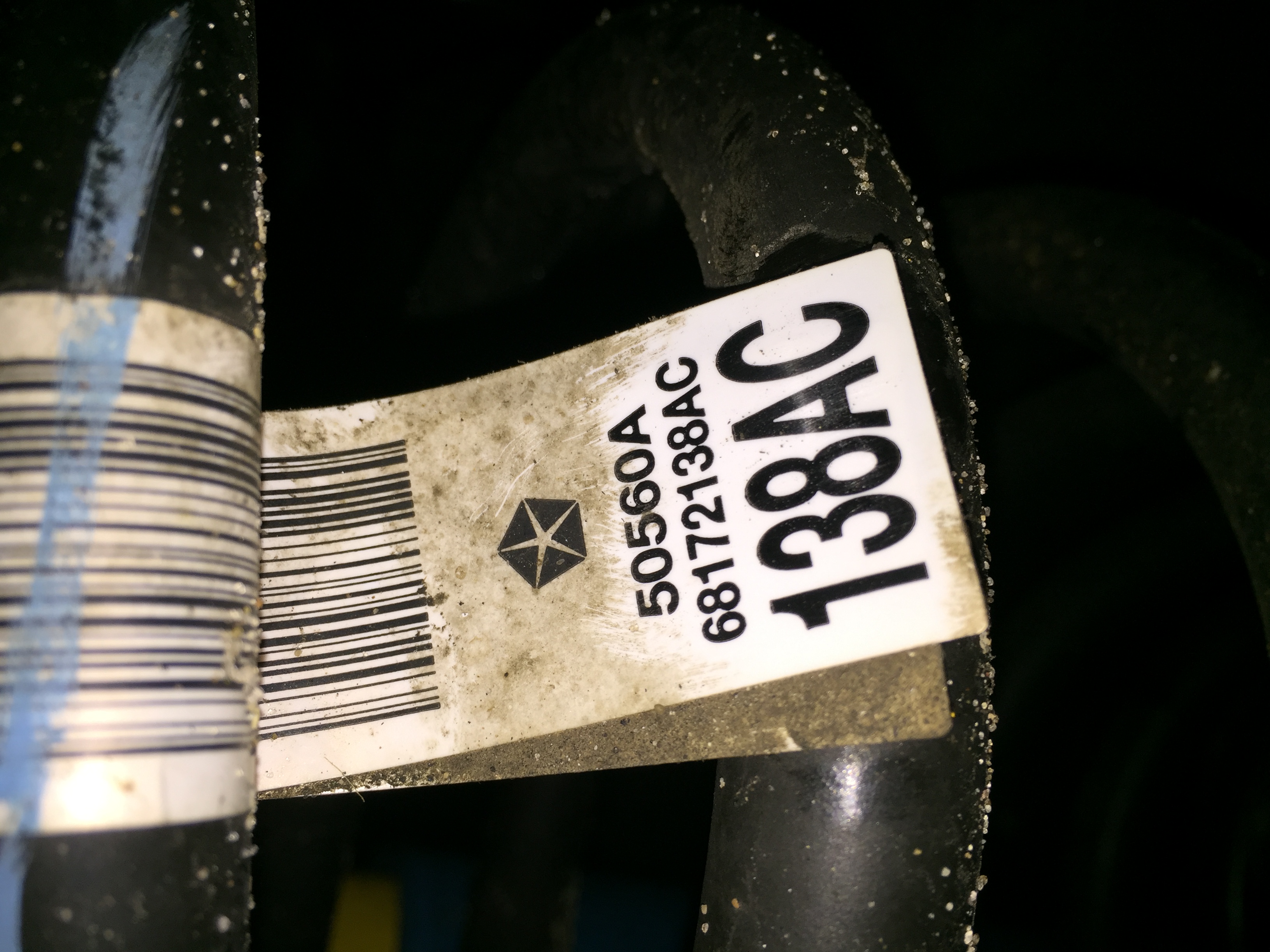

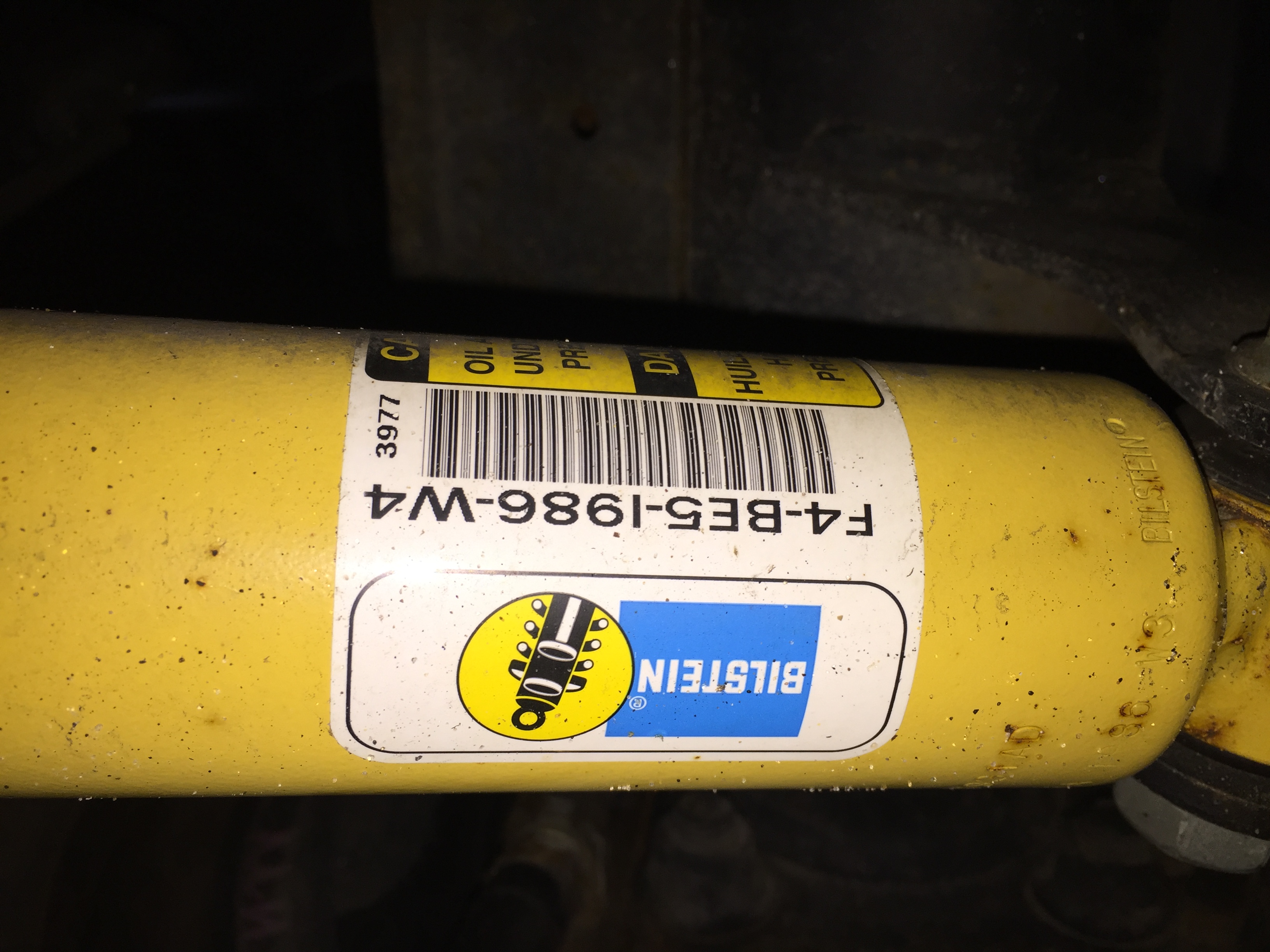

Post by olyelr » Wed Mar 01, 2017 2:40 pm
Heres what is under my 2016...
Front shock
Front spring
Rear shock
Rear spring

olyelr wrote:Heres what is under my 2016...
Thank you good sir!!! :wink:
Often the left and right springs a different you might to check for that as well.
I have heard that before, too. The rear spring numbers are the same, and the front passenger spring doesnt have a tag on it anymore so I cant confirm that.
Re: Power Wagon shock and spring part numbers.
Post by olyelr » Wed Mar 01, 2017 5:39 pm
Oh, and the sticker for the front track bar part number is too worn off to read the numbers, and the rear track bar doesnt have a sticker on it at all.
