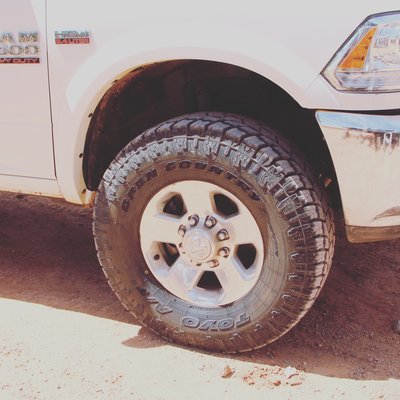

Toyo Open Country AT/II 35x12.50 on stock wheels, no rubbing on Radius or Sway bar.

You do quite a bit of off roading, any issues so far? Do they make an "extreme" version in that size for more aggressive looking sidewall?MikeKey wrote:Toyo Open Country AT/II 35x12.50 on stock wheels, no rubbing on Radius or Sway bar.

That size is the Xtreme. [Yea they spell it with an X right on the side wall like it's 1994] I haven't had issues yet. I've seen guys with 37's have issues with them rubbing the fender liner when stuffed. I haven't really stuffed the tire in awhile.Kodiak wrote:You do quite a bit of off roading, any issues so far? Do they make an "extreme" version in that size for more aggressive looking sidewall?MikeKey wrote:Toyo Open Country AT/II 35x12.50 on stock wheels, no rubbing on Radius or Sway bar.
I think it might of rubbed a little bit on the fender liner. I know that GTOMike's 37's rub the fender liner like crazy when stuffed.
But no real problems. No missing chunks in the tires or anything that would cause concerns. They'll get put through the paces again in Moab in May.

Awesome, thank you! Happy with the overall performance compared to the duratracs?
