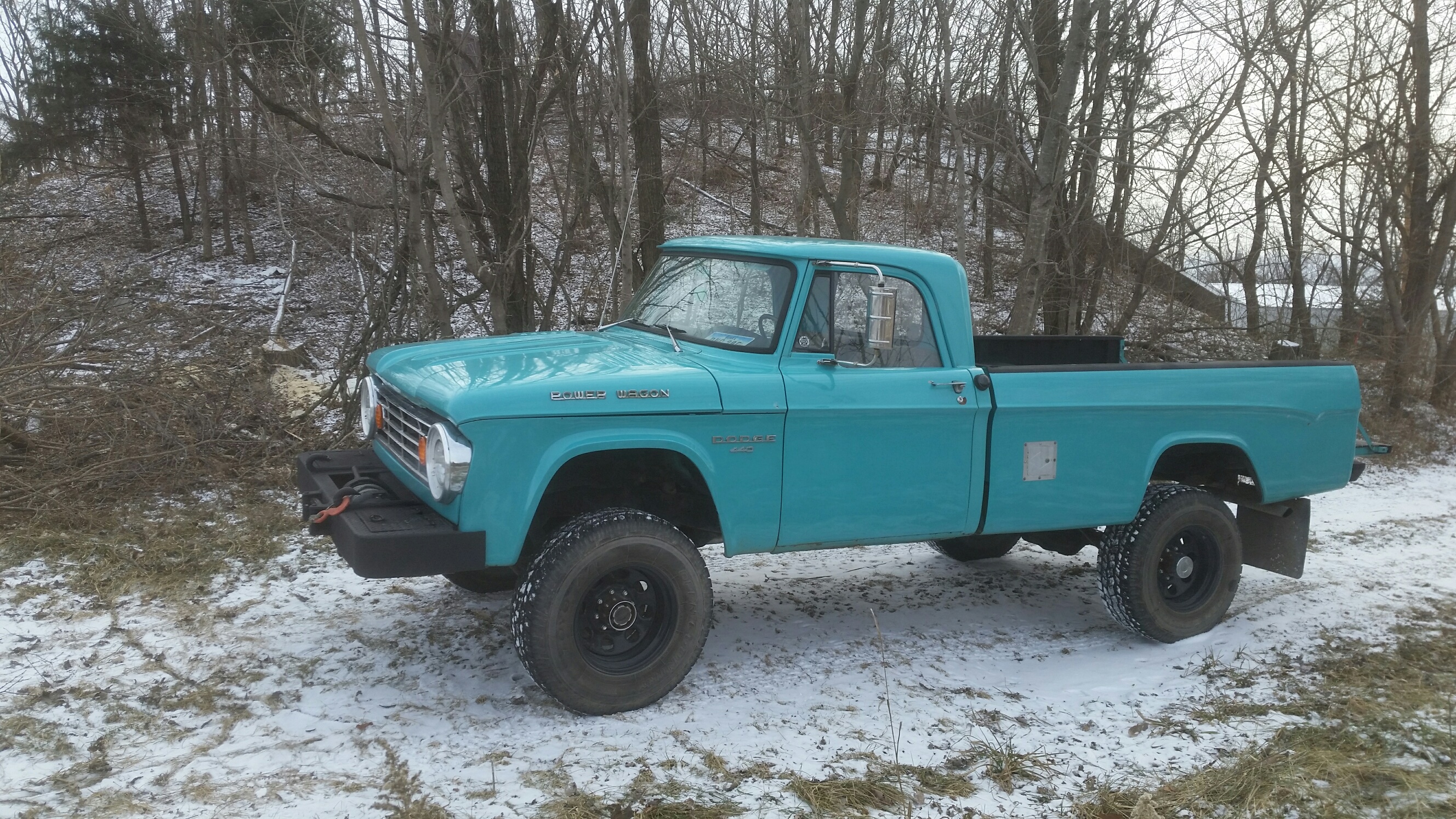

I know exactly what you are saying, the one tool I don't have in the shop is an alignment rack. I have however aligned many Civilian Power Wagons with a chalk line and achieved greater results than most modern alignment techs can do. It has been really hard for me to let these guys at my truck, it is something that i never do. Mainly because other than this my newest truck is my 1967 W200.

I really like my new PW, but this one holds my heart.
