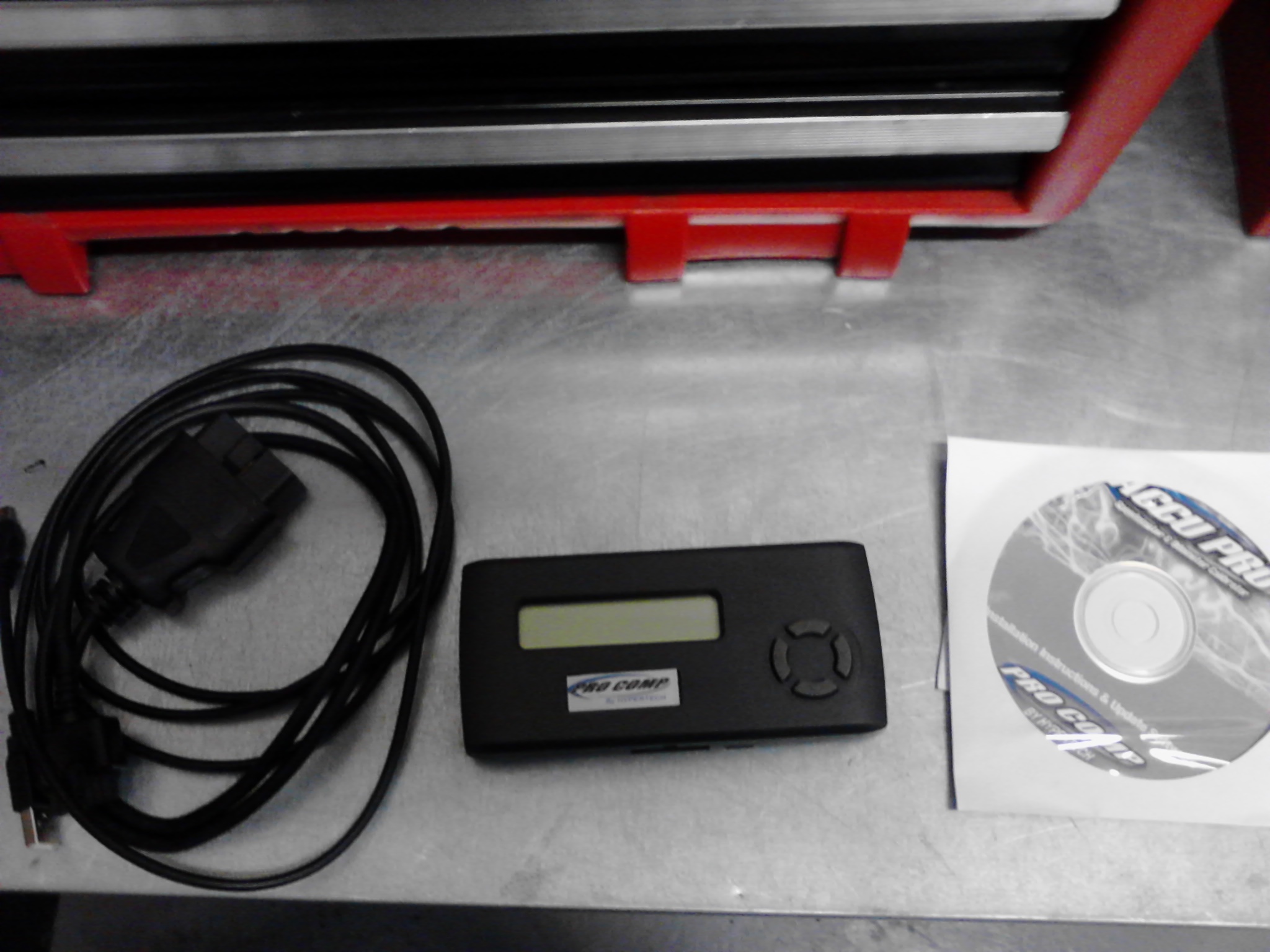

Re: Tuner Questions
Just got this the other day. We will see how much things change.
more to come...
more to come...
Re: Tuner Questions
Try to do some good base-lining before you install it so you can quantitatively share the improvements with usjailor97 wrote:Just got this the other day. We will see how much things change.

Re: Tuner Questions
Yeah, please let us know your thoughts. Have been looking at this for mine, the 37`s exaggerate everything.jailor97 wrote:Just got this the other day. We will see how much things change.
