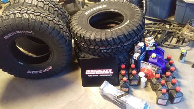

So last weekend was spent doing my wheel hubs, this weekend will be for upgrades.
Thuren high clearance control arms.
and changing all the fluids aswell, oil, transmission, transfer case, and diffs.
I'll post before and after photos of the arms and tires once finished.
General Grabber X3---37x12.5r17.Thuren high clearance control arms.

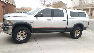

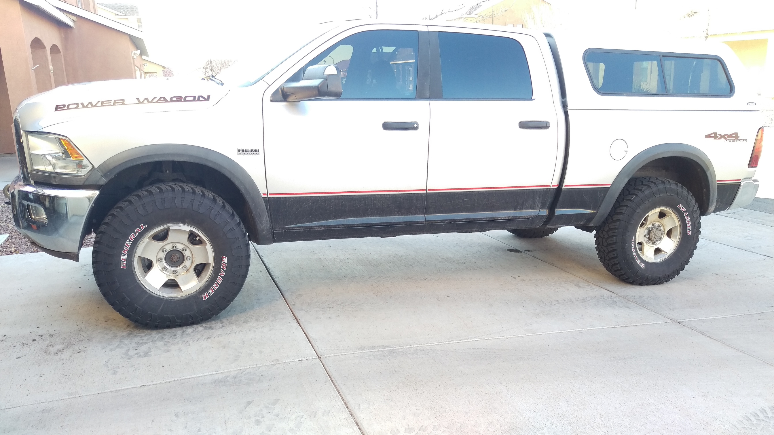

So I got the X3s on the truck finally. My wallet was raped in the process! Since the auto hobby shop's tire machines were down I had to have them mounted and balanced in town. Because I did not buy from any of the retailers in town, I got the privilege to pay the premium, full price for their services. The only place in town here that was willing to mount and balance 37's was discount Tire. All the other places said their machines could only do 33's and a few said 35's. I even asked if they could just unmount the old tires and mount the new ones and I would balance them later, and no takers on that. So $200 dollars later, my truck has new shoes on. I did pay for the lifetime balance, rotation, repair, which is extra if you didn't buy the tires from them. So saving a couple bucks on the tires cost me in the end. Again, only because the machines at the auto hobby shop were down.
Before: After: The only rubbing I have is a slight rub on the upper arm at full lock, and some on the swaybar at full lock. If you look at the photos, my front bumper is a little bent in/up on the ends. Sliding down slick mud into a dirt wall is a sure way to stuff your bumper a little! When I hit speed bumps at normal speed, the tires rub the plastic at the bottom of the bumper. Once I pull my bumper out some, I should have no problem.
Having the tires on only a few hours now, one thing I can say is they are a lot quieter than my old tires. I can actually hear cars pass me on the road vs before I just heard the hum of my tires. I can listen to the radio at a lower volume!! I'll provide some feedback once I get off-road and run them through their paces.
