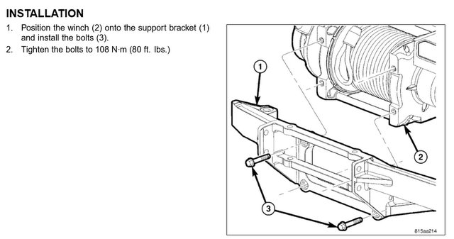

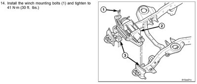

I replaced my winch mounting bolts a few months ago and got a set online at Bolt Depot (see link below), they're cheaper than the dealer and better quality to, torque them to 80 ft. lbs.drdfblackm wrote:Can anyone tell me the size of bolts for mounting the winch to the carrier? Are there any washers or lock washers used to mount the winch to the carrier? I can't find a parts diagram that shows the winch mounting to the winch mount.
https://www.boltdepot.com/Product-Detai ... duct=17524

[/quote]coder wrote: ... torque them to 80 ft. lbs. ...
... in addition to what coder said ...
