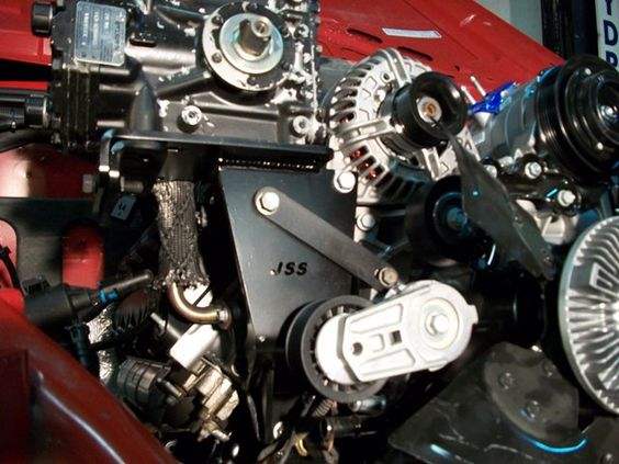

Re: Portable Air Compressor
I can't find the pictures of it now, but I believe it was mounted on a Hemi engine that had been transplanted into a Jeep of some kind, with a non-stock air box setup. Think it was a link on Dodgetalk. Either way I remember for sure the compressor was to the left of the alternator laying on its side. In my truck with the compressor in that position I don't have much room for the fittings coming out of the compressor head, not to mention any kind of belt adjustment leeway. I haven't looked at it in awhile, but I vaguely remember thinking if I set the compressor slightly higher over the alternator, and left myself enough room for the fittings and belt adjustment It would barely have enough room to clear the hood when it closes. I remember thinking that the mount was uncomfortably close to the "hot" stud on top of the alternator too.

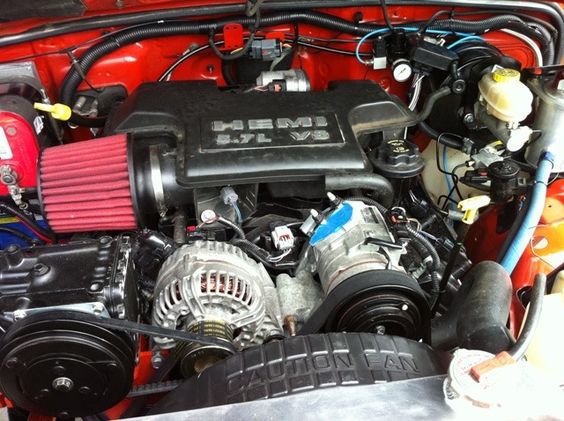

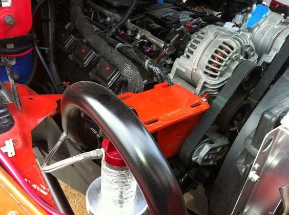

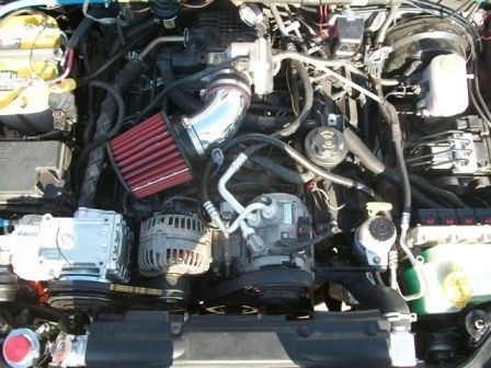

Here's the pictures I saved from Jeep Speed Shop about a year ago.

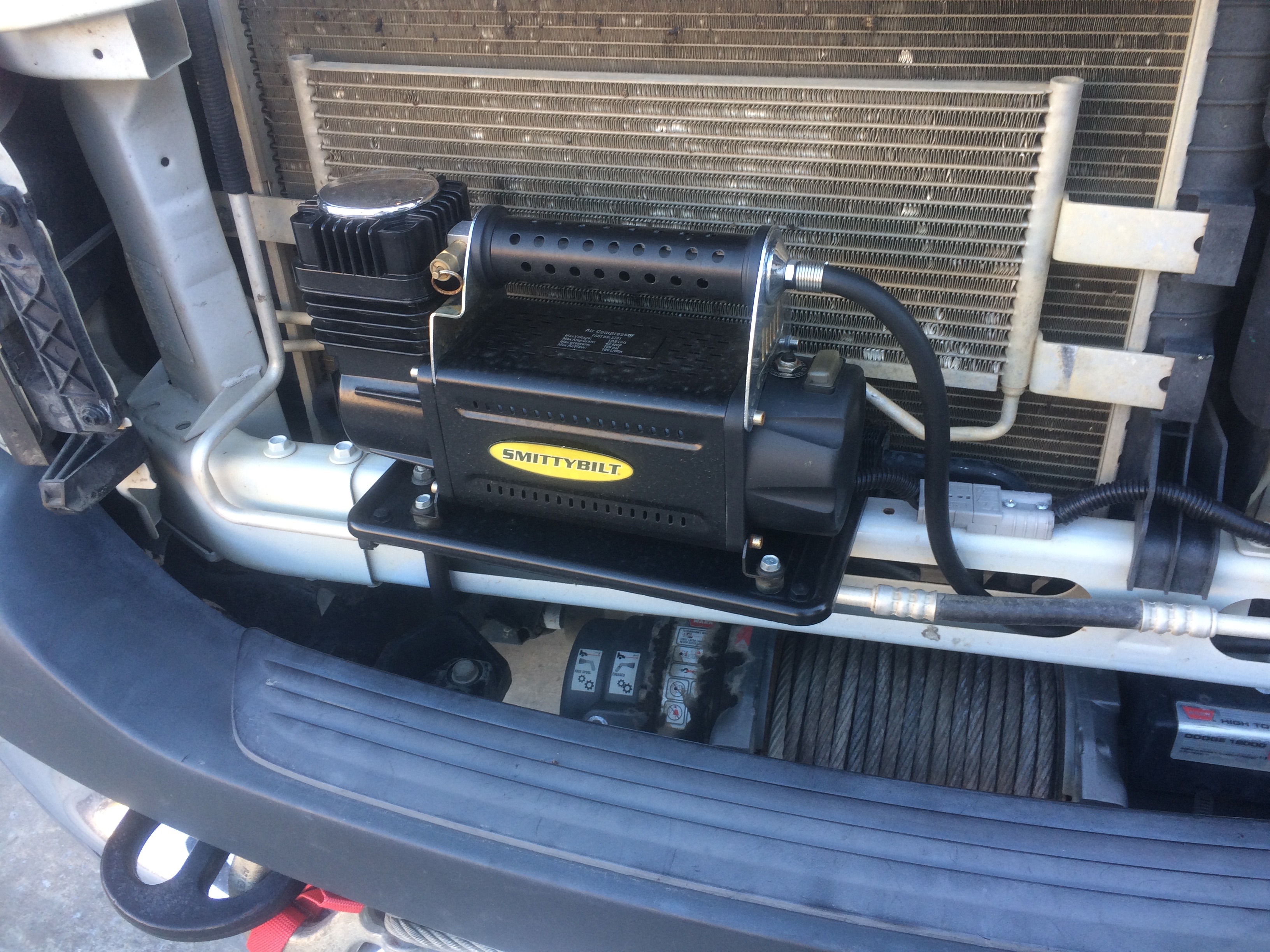

York compressor mount on a 5.7 Hemi conversion in a Jeep: I ended up buying a Smittybilt compressor and mounting it behind my grill, courtesy of Ducky's Dad for the inspiration. (Thanks D.D.
I just couldn't justify the expense for a York system, for something I would only use a couple times a year.
I still need to do a tank and plumbing, but I'm in no hurry.
Boy....that's a tight fit.

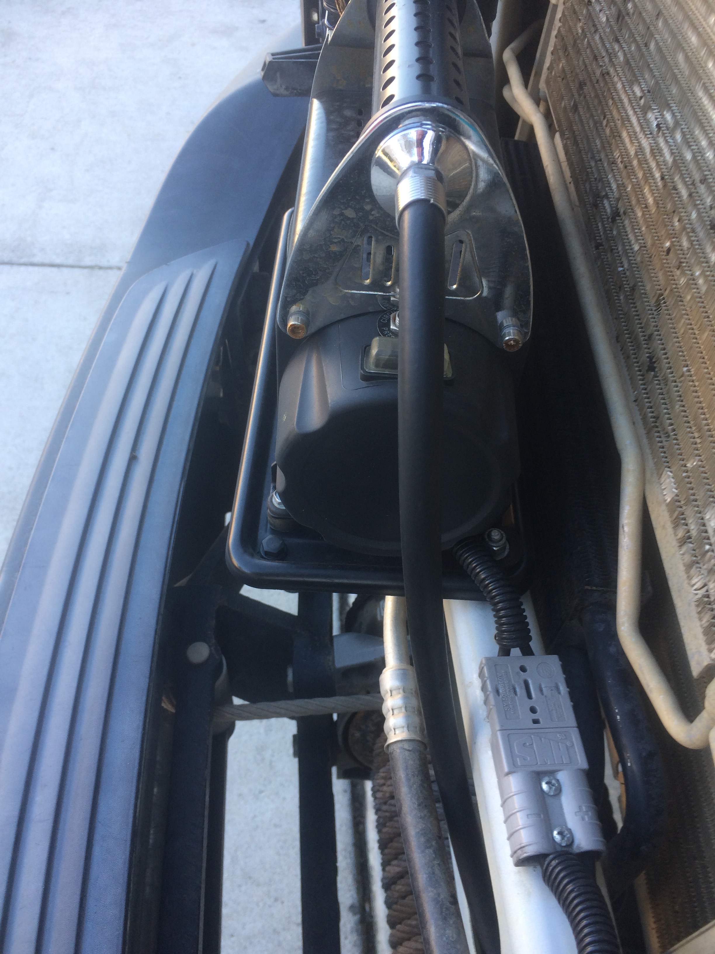

I used to maintain a fleet of tow trucks and they all had York OBA with 9 gal. tanks and they got used everyday and were awesome. The problem with a York system is that it's not truly portable. If I remove 3 bolts and disconnect a wire connecter, my Smittybilt is portable again and self contained in a canvas bag. When I buy my new 7th gen. retro flat fender PW, I'll already have an air compressor for it. I think It also has the same or better CFM numbers than a Viair, if I remember correctly.
Nice!Retired BLM Rig wrote:
So do you have a jumper cable connection wired up to a 50 amp quick disconnect so you can use it as portable setup, or is more or less permanent mounted?
Yes. Dismounts in a couple minutes, still portable with quick connect on original jumper cables.olyelr wrote: So do you have a jumper cable connection wired up to a 50 amp quick disconnect so you can use it as portable setup
