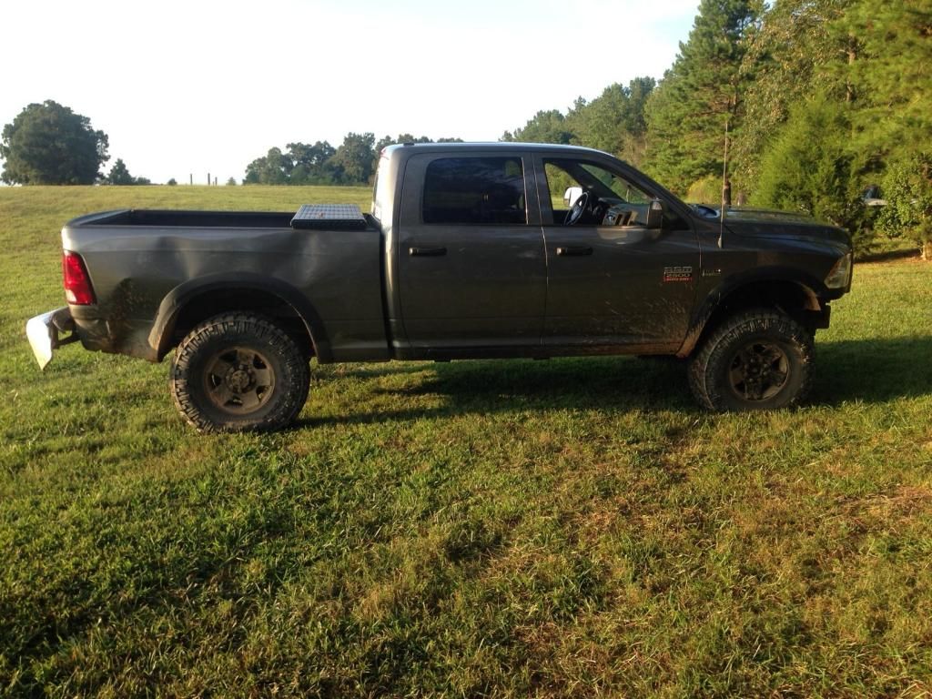

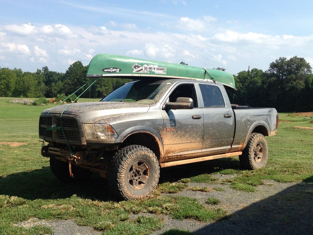

I have a 2012 Power Wagon with Carli suspension and 37x12.50R17 Nitto Trail Grapplers on my stock wheels. My control arms are the early Carli MIG/mild arms so, they do not have as much clearance as the newer arms. I have the 2.5 performance kit (2.5" King stainless shafted remote reservoir shocks) with the multi rate coil springs, Carli's normal rear lift springs (not their long travel), fabricated towers, and Thuren rear shackles. With the Thuren shackles on the middle whole, I ended up with approximately 2" of front lift and 1" of rear lift. (it is listed as a 3" lift but, that is 3" for a non-Power Wagon) The only clearance issue I have is my tires rubbing my control arms preventing steering from reaching full lock. I think the new high clearance arms allow more steering angle than mine do though so, should be an improvement over my setup.
The suspension is actually a bit firmer than my stock suspension was. It is clear that it is built for use at speed as it smooths out greatly with increased velocity. That's a bit opposite of what I usually use the truck for offroad, which is rock crawling. Overall though, I am very happy with my suspension setup. For a lifted truck, my truck feels very sporting and (IMO) actually rides better than a stock 2014+. To me the stance looks great, I think the truck should have come this way stock!

Your bumper fell off.
Re: 2013 PowerWagon looking to lift
RAM4ROKS, I am not so sure there is any other individual out there who has used and abused their PW anymore than you have. Congrats!
I believe "bumper" should be plural.MikeKey wrote:Your bumper fell off.
I call that a field upgrade Mike.MikeKey wrote:Your bumper fell off.
LOL! Thanks, I think!olyelr wrote:RAM4ROKS, I am not so sure there is any other individual out there who has used and abused their PW anymore than you have. Congrats!![]()
That may be true of the 4th gens but, a couple of the crazy 3rd gen guys are rocking Wagons that make mine look showroom fresh!
The front bumper didn't get too awfully beat. (4 small dents?) It's the rear that got almost ripped off by a tree and then I just took a Sawzall to it and the fenders!:
Going to have to remember that one!DamageWagon wrote:I call that a field upgrade Mike.MikeKey wrote:Your bumper fell off.
Only problem with not running a front bumper (or those anti-submarining or whatever bars) is that my winch mount frame now has some gouges in it.
