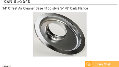

Re: Vararam CAI?
Post by Colibri » Wed Jan 25, 2017 3:59 pm
I've been thinking about doing an old style 14" round air cleaner like on muscle cars. Looks like you need a silicone coupler a base with offset intake and need to drill a hole for the iat sensor and you're golden.
