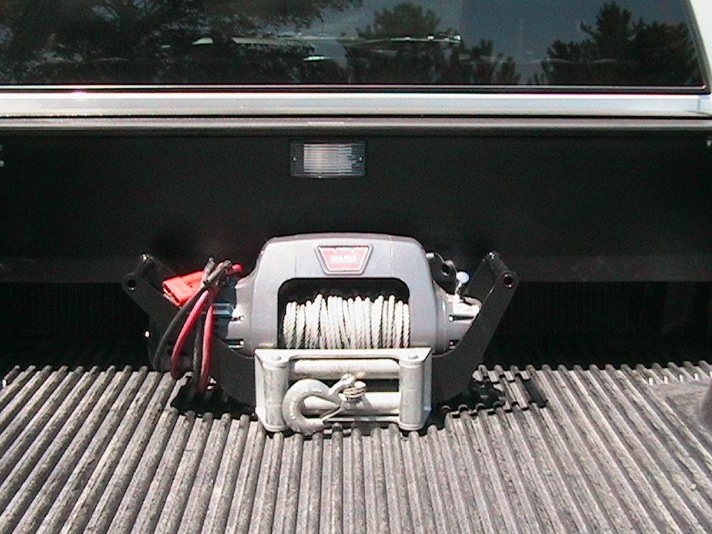

I have the same winch on the same mount that I have been using on the back for a few years. Works great

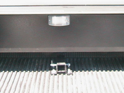

this is what i did to my ole 05' PW. mounted a warn 9.5 winch in a winch cradle. bolted a hitch on the bed to hold cradle. then when i needed it i just put the cradle to the truck hitch with power and it was all good. i didn't want to have winch mtd. in the rear hitch full time because the departure angle would suck.
