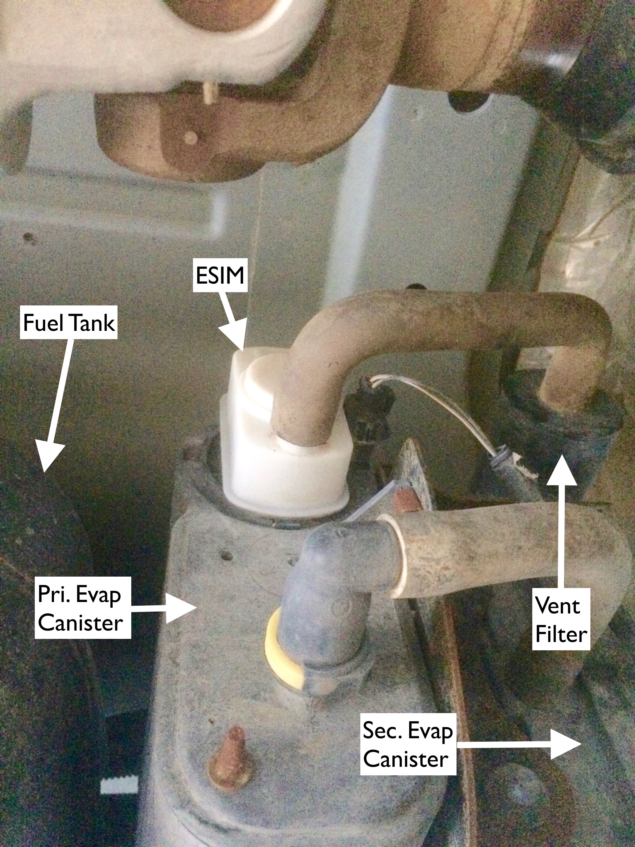

Next on my diagnostic list was to carefully check all of the rubber and plastic lines in the evaporative system for cracks, splits or loose connections. I started at the evap/charcoal canisters mounted just in front of my fuel tank and followed each line to and from the canisters throughout the entire system. The hardest ones to check are on top of the fuel tank, but a good flashlight and mirror can help with those. I didn't find any problems with the lines, so now it was time to focus on components.
The first and most obvious component is the canister. It's pretty well protected between the frame rails, but you never know when a stray stone or piece of road debris may get kicked up there and damage something. Mine looked good with no signs of splits or cracks.
Every evap system has a vent/inlet somewhere, mine is above the transmission bell housing.
If pressure needs to be vented or air needs to be drawn in, this is where it happens.
The cap is just an open restrictor to stop debris or bugs, like mud dobbers, from building a nest and plugging the vent line.
The next component inline is the filter, this is to stop any dust from entering the evaporative system. It's a mini air filter inside a plastic housing.
My filter sits on top of the evap/charcoal canister assembly.
The next component is called the "Evaporative System Integrity Monitor" (ESIM for short). It locks on to the canister. This is a double weighted check valve that allows pressure venting or vacuum relief at predetermined pressures based on the weight of the check valves.
The ESIM is the bad boy that will turn on your check engine light if it sees that pressure/vacuum isn't being maintained in the system. It's a leak detector, that's what the two wires are for.

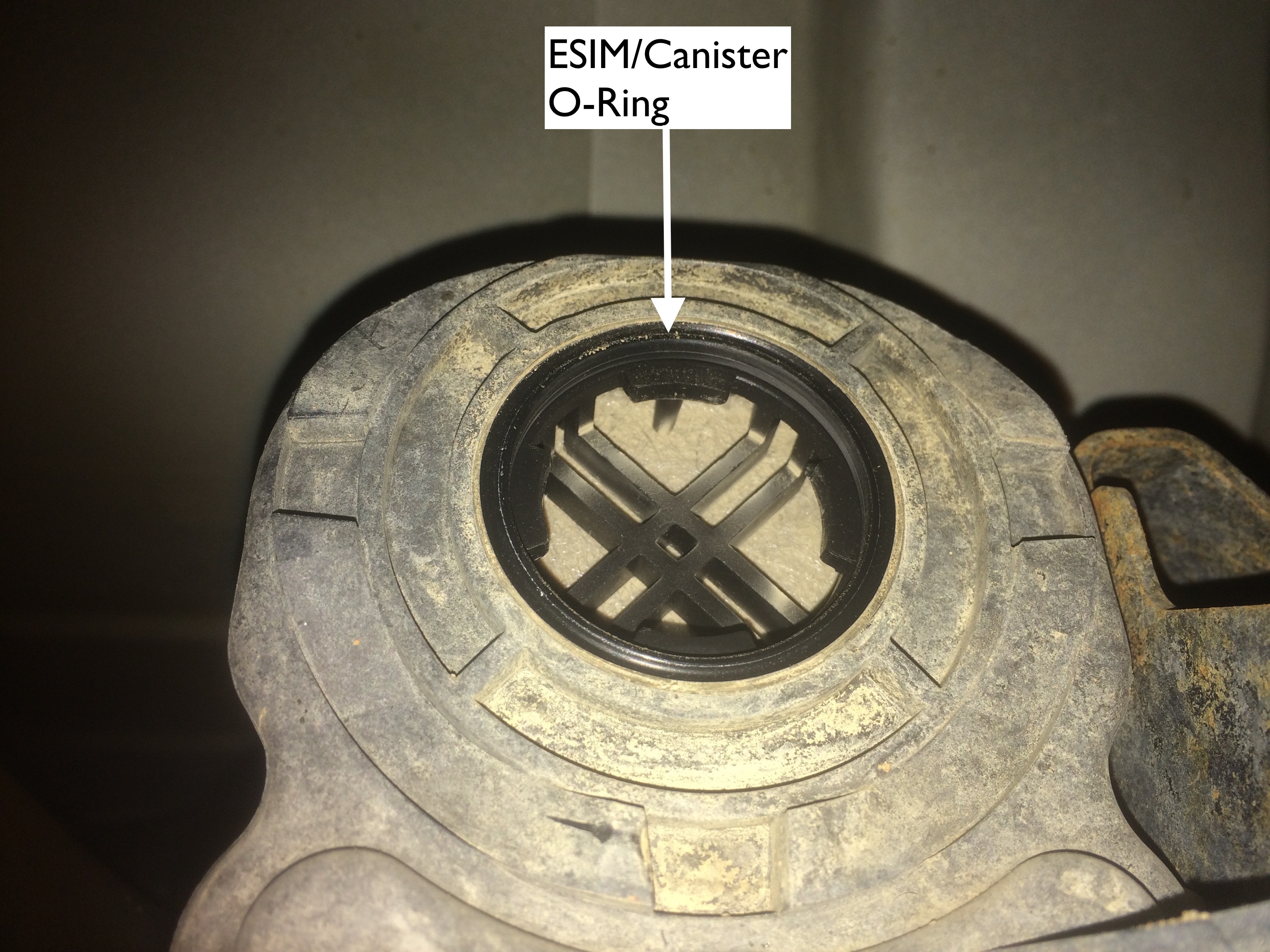

To remove the ESIM, lift up the locking tab and rotate it 45º clockwise.
There's an o-ring under the ESIM, make sure it doesn't get lost and check it's condition.

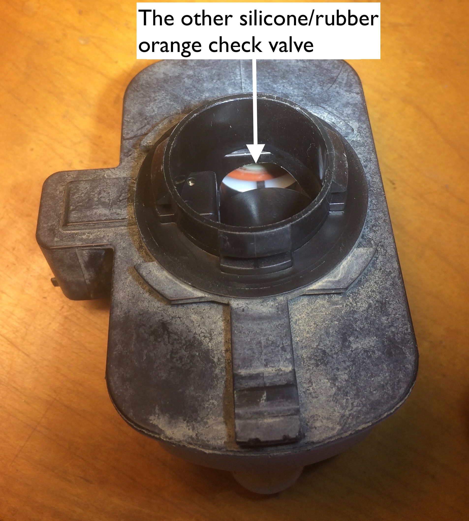

The ESIM is glued together and is supposed to be non serviceable :thppt: . Looking inside the ESIM you can see that a layer of superfine dust made it past the filter media and took up residence on the check valve causing it not to seal.
My solution was to spray aerosol brake cleaner into the ESIM, shake it around and then quickly blow it out with compressed air. I did this two or three times until it looked clean. Make sure not to let the chemical sit for too long as it will ruin the rubber check valve (spray it in, shake and blow it out). The ESIM is available to purchase as an individual part for $30-40, but why buy it if you can clean it.

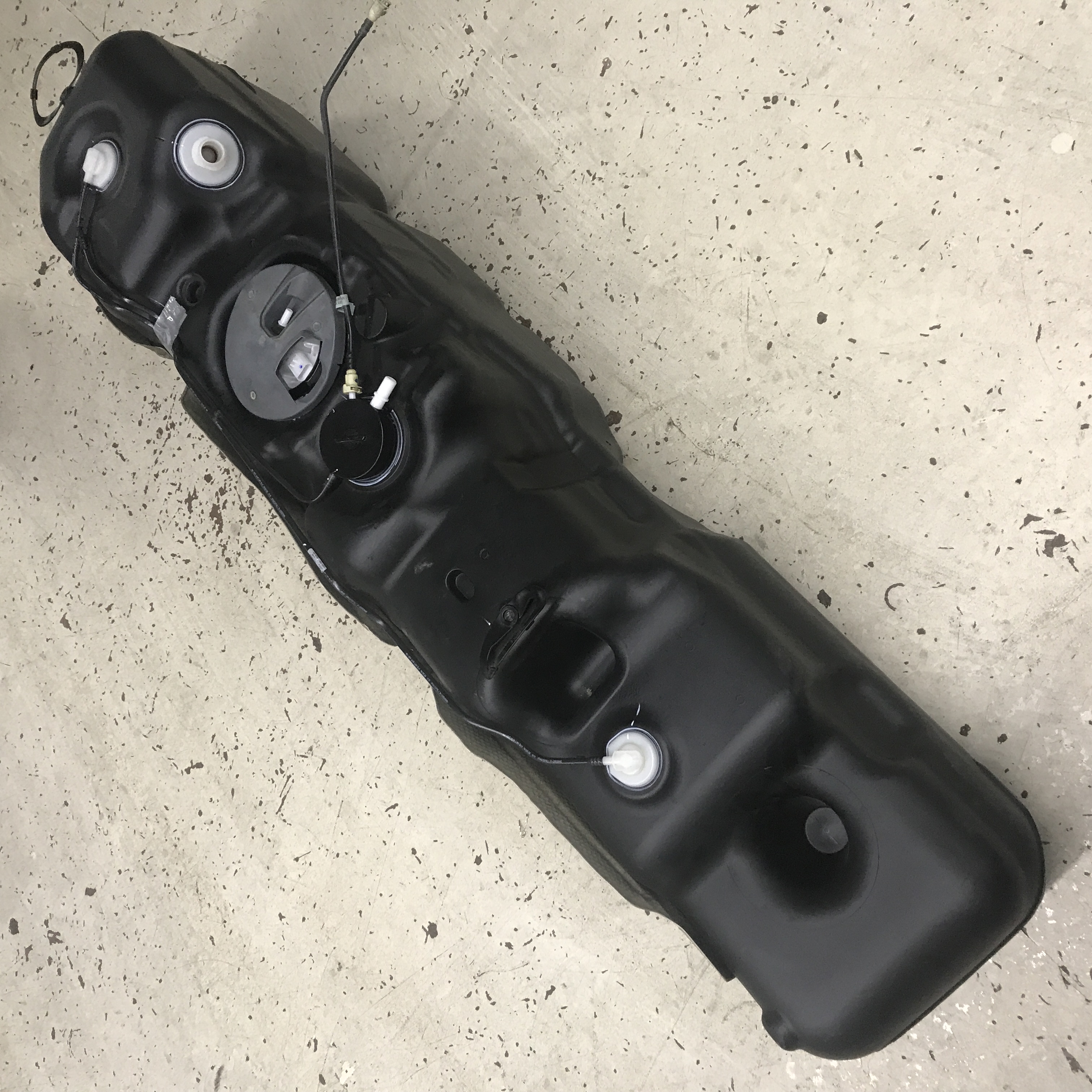

Well it's been 4-1/2 years since my original post and my check engine light came back on for this same code a couple months ago. I have a mandatory smog test coming up next month, so I figured I better get to the bottom of it. I revisited all the same diagnostic procedures as discussed originally, but to no avail. It came down to having to do a smoke test on my evaporative system to find the source of the new leak. It was such a small leak on top of the fuel tank, I had a hard time finding it.
A smoke machine generates smoke for a visual aid in locating a leak, but there's also a flow meter. There's high flow while the system is being pressurized, but if it's truly sealed then it should slowly decrease to zero flow. The only way I was able to achieve zero flow was to push down on one of the plastic lines on top of the fuel tank. After using a mirror to get a closer look, I could see that one of the plastic fittings was cracked on top of the liquid/vapor separator. Time for a new fuel tank. :cash:
I debated trying to see if I could repair the leak, but after discovering that a new tank was still available, I decided to just bite the bullet and be done with chasing leaks in an old, dry, brittle, plastic tank.
On this tank the liquid/vapor separator sits in the middle of the tank.
It has two quick disconnect lines and one sealed line.
It was the sealed line that had the cracked fitting.
With almost 130K miles, I decided to replace the fuel pump while I was at it. I opted for a VDO unit, since they're an OEM supplier and make a quality product.
Here's the new tank and pump ready to go back in.
It's been a week since I did the repairs, no codes, no check engine light. Now it's ready for the biannual smog test. :patriot:
