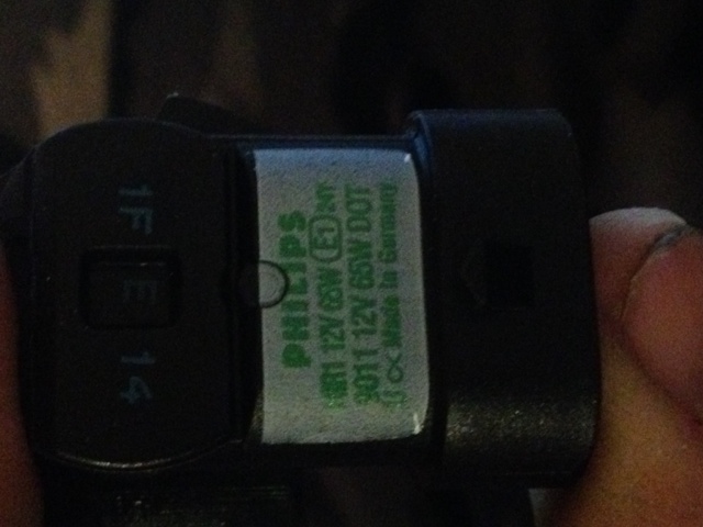

Strange that they said they are only for OEM's. Anyway here are a couple pics maybe it will help

Thanks. Pics are helpful, but since they are rebranded for NAPA, the P/N only works for NAPA. I had that discussion with them last week on some Swenco connectors that were rebranded for NAPA, at about four times the price that Swenco charges. But, NAPA had them right now and Swenco needed to ship from 2,000 miles away.
Re: Fog light upgrade
got ya. Well at least this may help cross reference. IIRC the corvette used these bulbs in their high beams. Possibily the current one but I'm not for sure. I know they are using HID setups for the Lows
