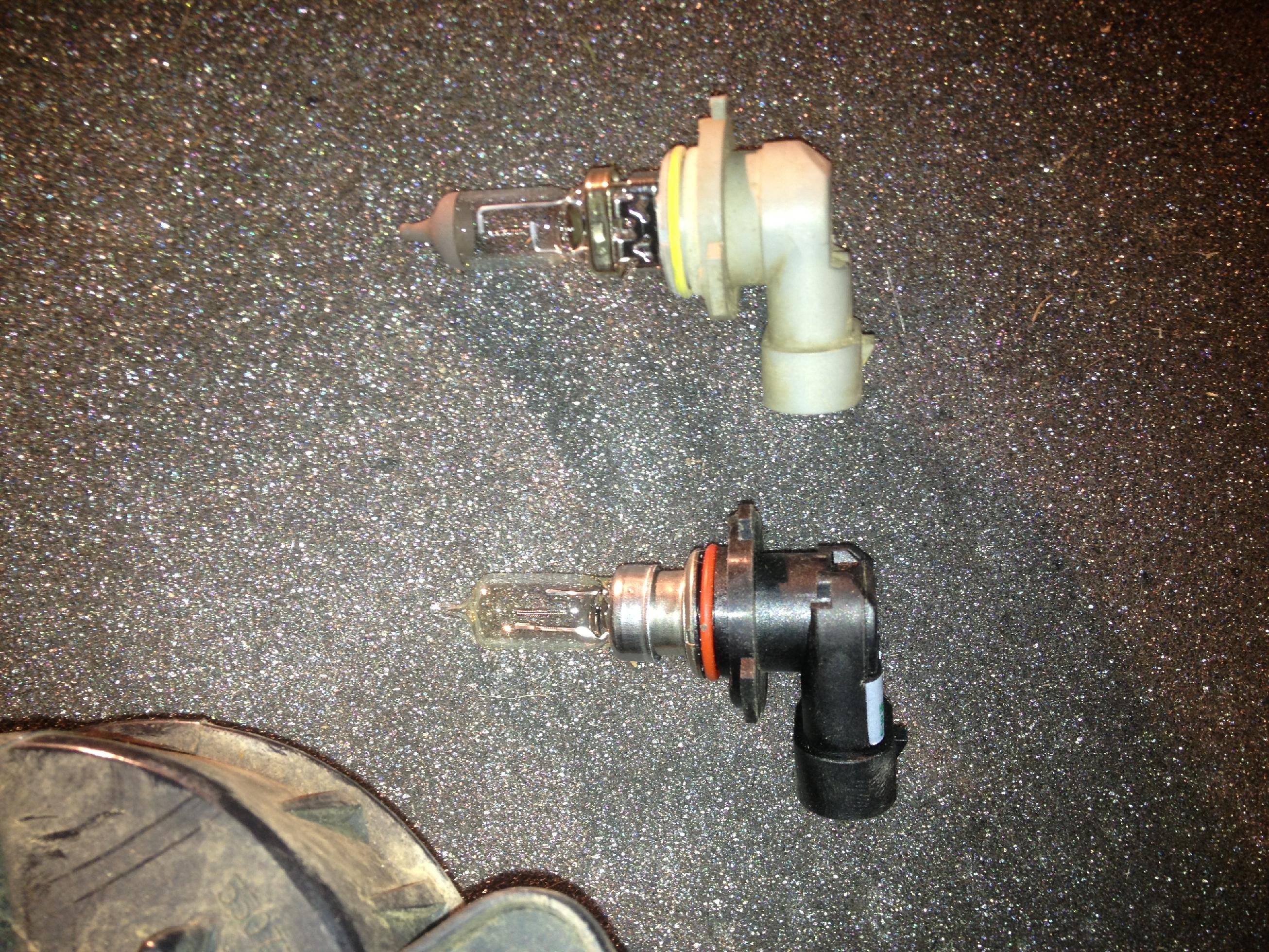

Ok so the bulbs side by side comparison

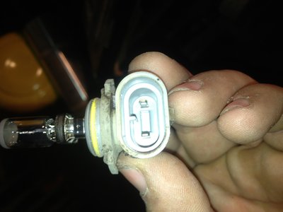

the connector is slightly different. Shave the to plastic things with knife. Trim one of the ears. I had already trimmed the other for a different project. I tested the bulb in one of my spare fog lights and it fits water tight.

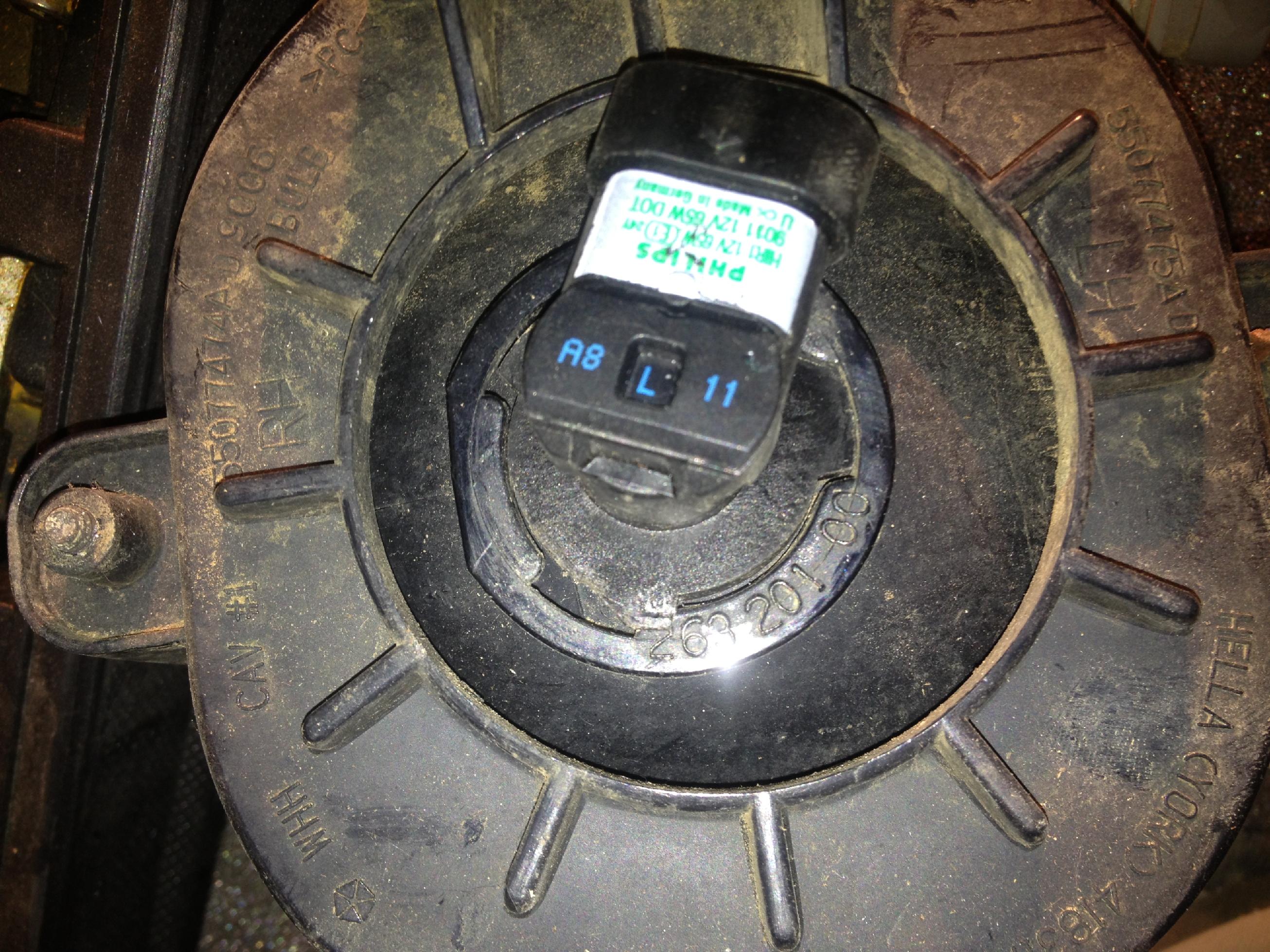

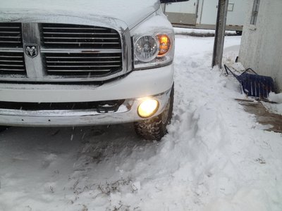

And bulb installed. Now the picture does not show very well. When you are standing in front of the truck it is at least 80% brighter. Also the 9011 I got is a 65 watt bulb. $52.00 is what i paid. That is only one bulb. I have to buy one more. I also don't use my fog lights alot so being this bright will be great when out hunting or in really bad weather. Hell they are frikn bright. Pictures to follow in a min. Let me point out we are having a wonderful winter storm for the last couple days and i was just out an hour ago in the truck. It's -10C here right now with wind gusting ast 35-45 mph.

wow the pic did not turn out well. It does not do it the credit it deserves. I also just found out that my amber passenger bulb needs replacing. This upgrade is worth it. It still is a halogen but it is so bright. Easy to do too

thanks man. The black bulb is the new one and white is origional? On the pic with the black bulb in the fog light housing, is that black silicon around the base of the bulb? So your saying the new bulbs fit in the fog light fine as far as retaining clips, you just have to trim the wire conectors on the bulb some? Thanks again, i plan on doing this soon.

No it isn't silicon. Just have it sitting loosely. It fits perfectly as long as you nip the one corner of the ear just a bit. And yes the black one is the new one.
I took the truck out yesterday night to see. DUDE it was nuts. I actually turned the fogs off on the highway to pass vehicles. It is INSANE. Just ONE bulb too. I am going to get the second one as soon as I can get to the city.
It has been snowing and blowing hard here. Turning on the fogs was better than the high beams.
Just remember the 9012 will fit the plug with no mod and the 9011 needs the plastic guide removed. And the 9012 is appx 2400Lumen and the 9011 is 3000.

Man turning on the fogs is like high beams to the side now. The ditches light up so well. Best Brain Fart Idea EVER.
You can check it out at rallylights com. Just look in the bulbs under the 9011 and 9012.
