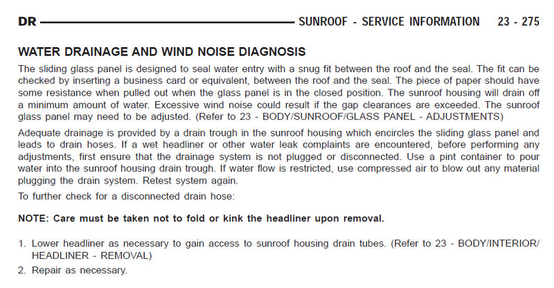

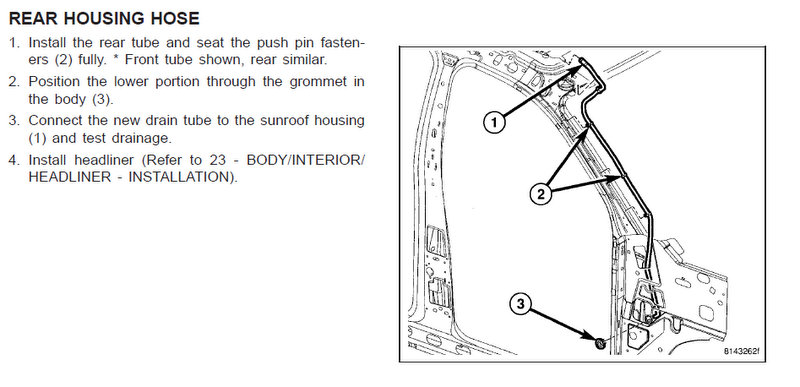

Now that it's rainy season I'm noticing a bit of water coming down front pillars. Anyone have a pic where front and rear drains are or can tell me where they are.

Maybe this will help... click pics to enlarge...
