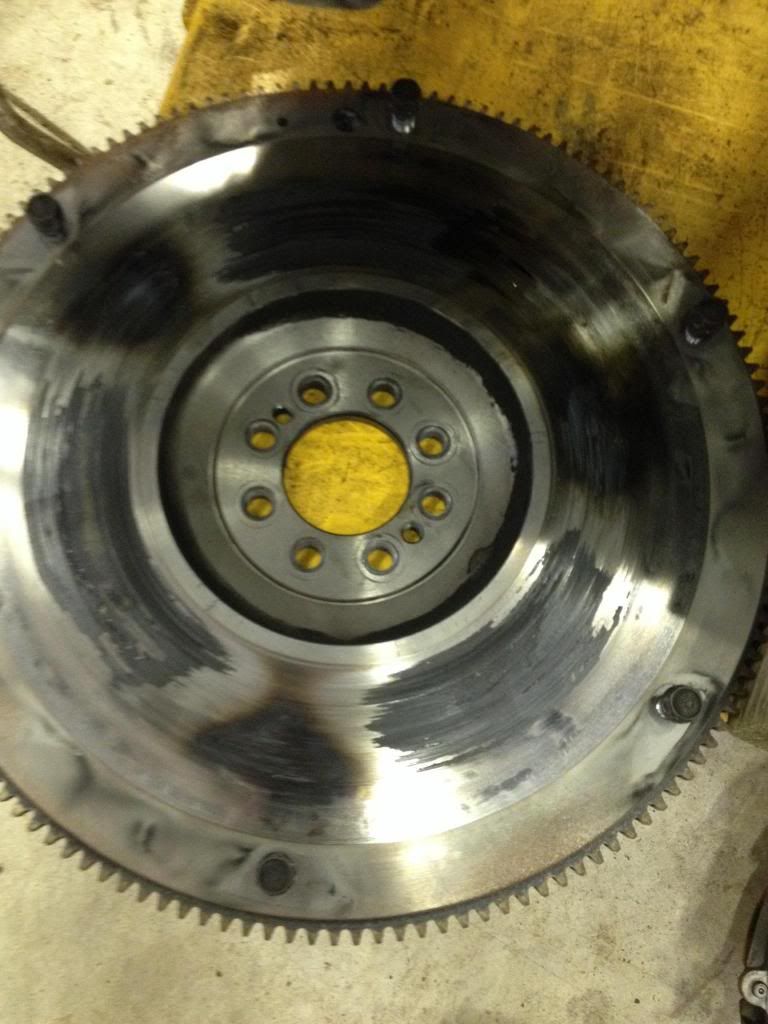

06Wagon also installed a CF and his did not stand up to the abuse of truck pulling. Below is pulled from his posts.
I think it's safe to say the the new Centerforce clutch is trashed.... Flywheel is hot spotted bad. And that was a new flywheel/clutch installed this past spring.
I think it's safe to say that their clutch isn't what it's cracked up to be. For a daily driver (or more normal driving) it would be fine.
My factory clutch lasted 2 years of heavy pulling and 65k miles. This one lasted 500 miles and about 10 hooks.
