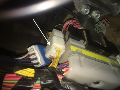

Re: Rear locker light flashing
When a similar thing happened on my 08, it ended up being a loose connection at the C137 connector above the parking brake pedal. It looked like it was good, but when I tugged on it, it came apart. When I plugged it back together, it resumed normal function.
It's the white connector with lots of yellow wires with colored tracers. This connector is inline between the dash switch and the smartbar.
I hope this works for you as well!

Re: Rear locker light flasbing
My 2012 is doing the same thing. Flashing when knob is in the unlocked position and wont lock at all once turned. Sway bar works fine. Is the sensor at the top of the rear diff a part of this locker config? Thanks for the picture above, will check that next.

I believe connector C137 only applies to the 3rd gen trucks. You would have to look it up in a 4th gen service manual to confirm. I think 4th gens have a connector out below the passenger side hood hinge, just follow your smartbar harness.chrisjameswagner wrote:My 2012 is doing the same thing. Flashing when knob is in the unlocked position and wont lock at all once turned. Sway bar works fine. Is the sensor at the top of the rear diff a part of this locker config? Thanks for the picture above, will check that next.
