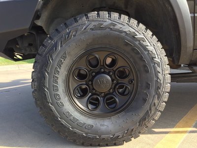

I am opening up a question to the forum. I need your help in better understanding the consequences of installing the AEV dual sport lift on my 2015 Power Wagon Tradesman. A very strong appeal to me for the lift is the ability to run 37" D rated tires at 50 psi (measured cold pressure). This combined with the 5160 Bilstein shocks, and 37x12.5R17 tires should provide a more comfortable ride on/off road. Additionally, the kit provides the Procal chip to correct the speedometer and TPMS tire sensors.
The question is: Can you still tow when your max D rated tire pressure is 50 PSI? The Ram door panel lists the recommended tire pressure as 60psi (front), and 65psi (rear). Although the procal corrects the tire sensor light, will I be underinflated for towing? I tow a 30' Airstream, which absolutely worst case could weigh 9,000lbs (usually around 8,000lbs w/gear and clothing).
I appreciate your feedback. I have already purchased the MOPAR regular 2500 gas coils for the lift. I want the D rated 50psi squish, but am concerned that I need the E rated tire, and the rough 65psi that comes with them. is there something that I am missing? I will include pictures below.

These are the tires that I ended up going with. D rated, Toyo Open Country R/T (37x12.5R17). They ride great. I commute with approx. 49 psi all around. I have not towed yet, but do not anticipate any problems.
