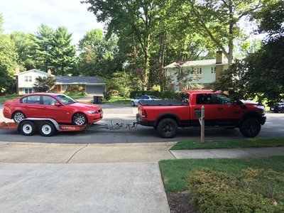

Towed my commuter car along with all my "unmentionables" (the entire bed & back seat packed with ammo & firearms
). Hit the scales in Dayton, 15,858lbs, so pretty heavy, more than I thought. You can see some definite sagging, airbags would've helped a lot, but I don't tow much anymore, so I wasn't even really thinking about the sag till I drove the car up on the trailer. I put the Firestone bags on my F250 and they helped a lot when going to and from AK with 8k LBs, anyway, drove 6+ Hrs of the 9 hr trip in a driving miserable rain, at night, though the mountains, and it sucked. The trucked averaged 11.1mpg with 4.88's & my new 37" Nittos aired to the tire max of 50psi cold. Truck rode as well as expected, had to see 6k RPM at times, and it was struggling slowing down hill. Tow/haul mode helps slot, but I still was heavily involved on the +- stick ...

Just to explain for the 100th time, airbags would not have helped. Your truck is sagging because the excessive weight on the rear is lifting the front. Scale ticket with the trailer unhitched would highlight that your front axle most likely weighted less hitched than unhitched. I know because your weight there is very close to my full setup and my truck doesn't sag, and I don't use air bags. And I've done the, 3 pass weigh in's. Truck solo, truck hitched with no w/d and truck hitched with w/d.
It's really a non-problem in your case, you can't use WD with those uhaul trailers. But I just want to mention that airbags don't solve weight issues, they just hide the problem by preventing your springs from compressing. It just improves appearances, that's it.
Otherwise, great report.

Yeah man, I know bags don't reduce tounge weight. I drove over CAT scales and have both axle weights, trailer weight, and tongue weight & got weighed empty (military move, need both). But the car hauler can't accommodate a WD hitch & even if it could, I wasn't going to drop $$ on one for a single trip. Bags would help alleviate the spring compression by exerting an upward force on the rear axle equal to that of the down force created by the very front heavy trailer tongue weight, thereby reducing compressive stress on the springs and restore damping travel, reduce fluid heat build up, but would not put more weight on the front axle however .MikeKey wrote:Just to explain for the 100th time, airbags would not have helped. Your truck is sagging because the excessive weight on the rear is lifting the front. Scale ticket with the trailer unhitched would highlight that your front axle most likely weighted less hitched than unhitched. I know because your weight there is very close to my full setup and my truck doesn't sag, and I don't use air bags. And I've done the, 3 pass weigh in's. Truck solo, truck hitched with no w/d and truck hitched with w/d.

Does a set of bags work the same as a wd hitch, well hell no. But they most definitely help the situation.
Re: Towing differences from 3rd gen to 4th
Also loading the heaviest part of the car that far past the trailer axles puts that much more on the tongue. Just balance your load better and you don't put as much direct weight on tongue
Yeah in most cases yes, but UHaul's direction is to front load the trailer to prevent "whipping", something they were all kinds of worried about for liability. The car has to rest completely against the forward stops to properly cinch the front wheels down with their ratcheting tire web, which attaches to the front of the trailer, no way to avoid the front load with that trailer, plus that trailer is solid steel, so it's a heavy ass mother empty.nts007 wrote:Also loading the heaviest part of the car that far past the trailer axles puts that much more on the tongue. Just balance your load better and you don't put as much direct weight on tongue
