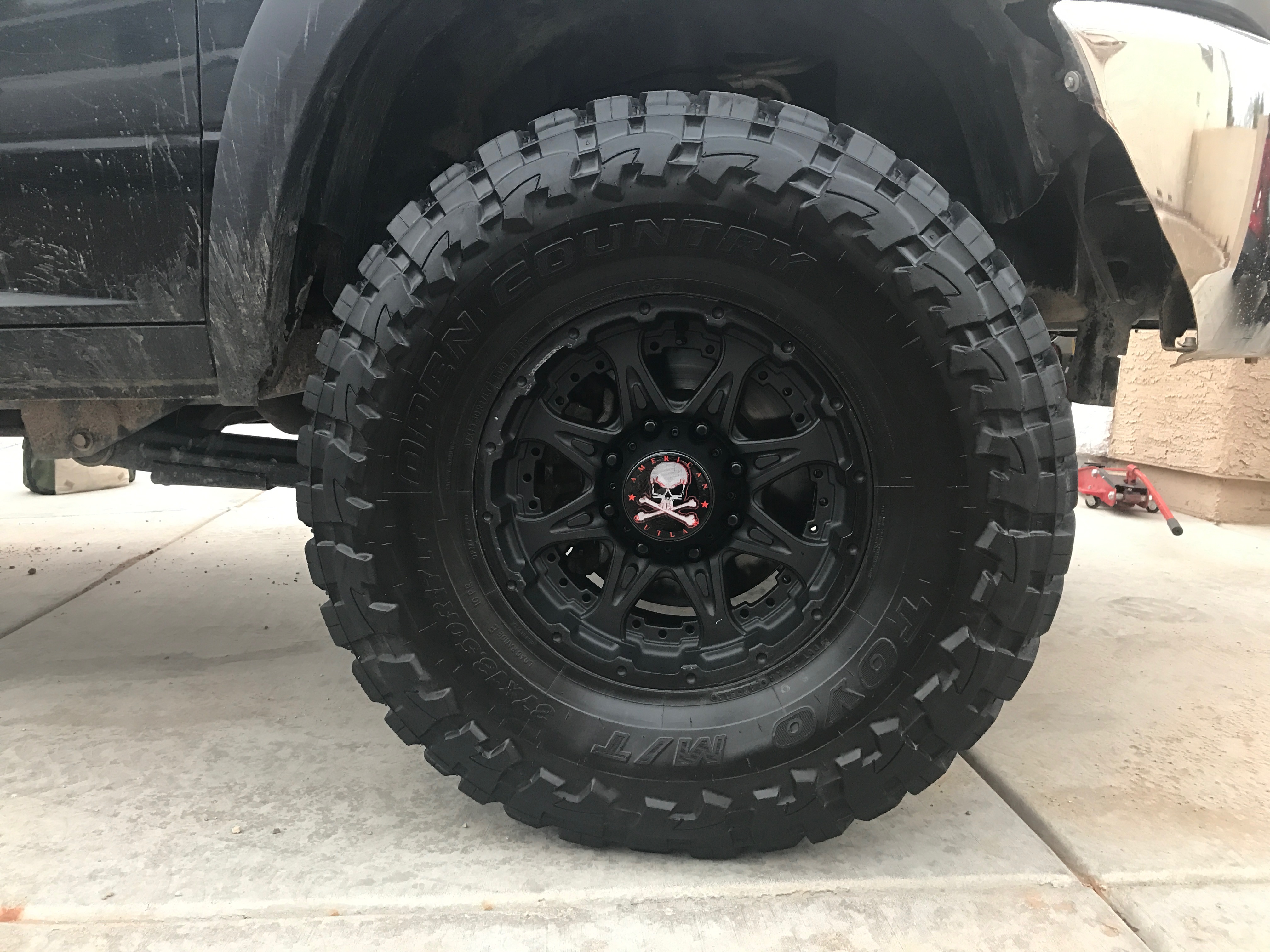

Driving a "new to me" 2015 power wagon. Please post feedback on 35" tires on a factory 2015 PW. I'm inclined to go with AEV Katla wheels and Toyo open country Mud Terrain 35 x 12.50 17s. I'd also like to know if a 35" tire, maybe a narrower one on factory rim, will fit in stock spare tire set up. Thoughts appreciated!

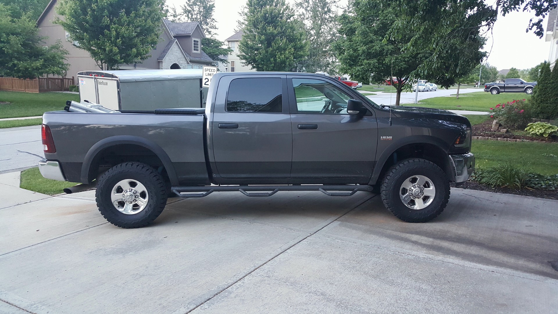

Toyo Open Country AT/II Xtreme 35x12.50 x17 - Fit perfectly, excellent tire, no rubbing. 2015 Power Wagon, stock otherwise.
Even fits the spare area
Overall very happy with the tire and the looks.
Re: 35" tires including spare in factory 2015
Thank you for the spare photo that was what I was seeking

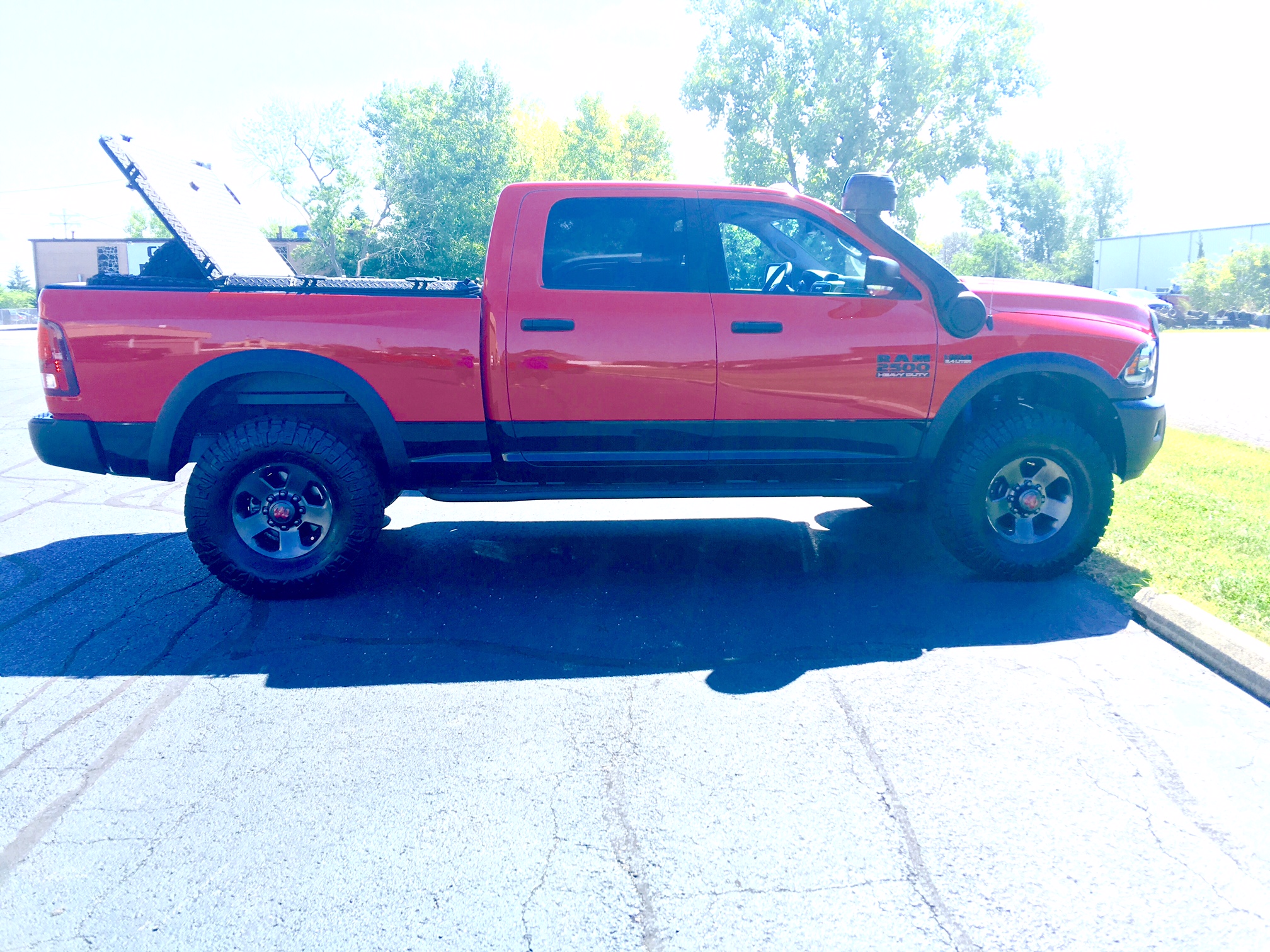

35 inch RTs fit rub free on all stock 2015.

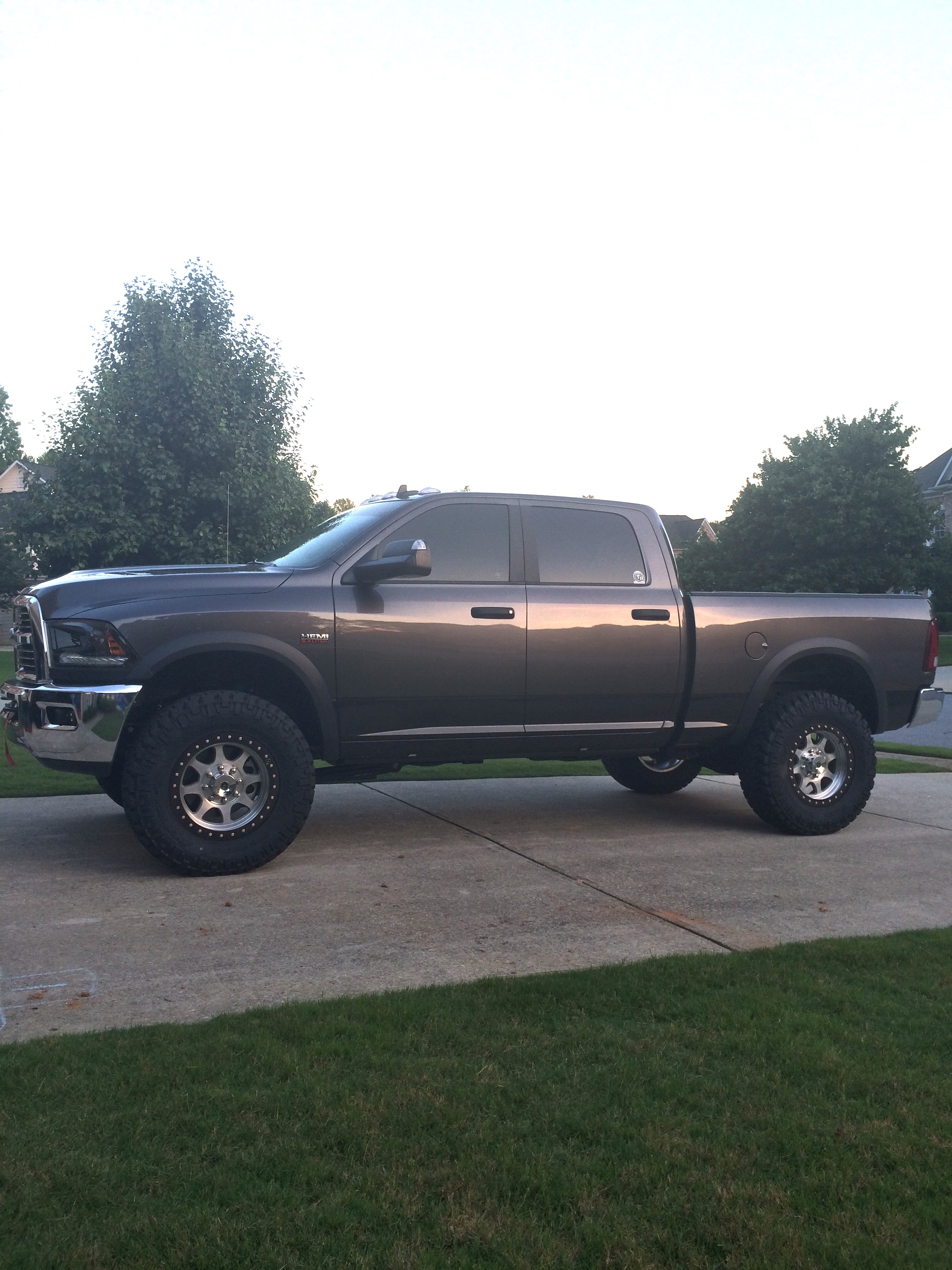

35's are truly a great choice, probably really the best all around purpose size for our truck....but if you've got $$ for 4.88's or 5.13's---->37's.joeschmidt wrote:adeluca73 wrote:It's gonna happen, so I might as well start it off:::::::>![]()

Drink the kool-aid man...everyones doing itadeluca73 wrote:35's are truly a great choice, probably really the best all around purpose size for our truck....but if you've got $$ for 4.88's or 5.13's---->37's.

I agree with Dr. D. If you're going to leave your truck stock just go with 35's. If you plan on a little suspension work and maybe gears in the future, 37's are the answer.adeluca73 wrote:35's are truly a great choice, probably really the best all around purpose size for our truck....but if you've got $$ for 4.88's or 5.13's---->37's.joeschmidt wrote:adeluca73 wrote:It's gonna happen, so I might as well start it off:::::::>![]()

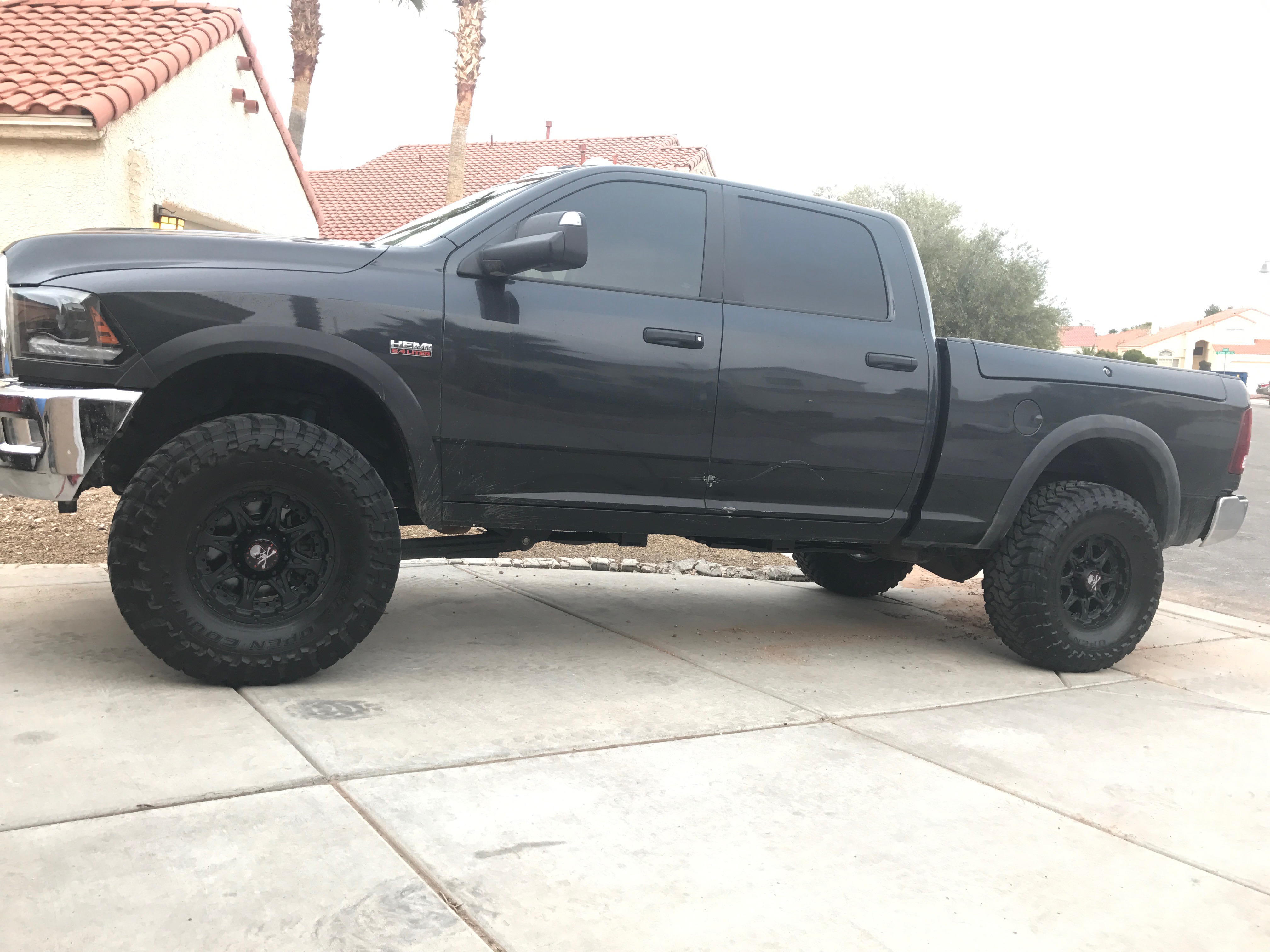

I went 35's for a few months, spare fits fine, just push the heat shield over with your boot! Now I am on Toyo MT 37x13.50 r17 and American Outlaw +15 offset wheels. 1.5" leveling kit with shock extension, Thuren track bar, lots of trimming. Still rubs a bit with full flex. Hopefully will do the full Thuren Overland or King kit over the next year. I still have the 35" spare mounted, For the 37" to work, first look for one that is more like 36" x12.50 or less. Next you'll have to move the exhaust over. Hitch might be an issue as well. I hope to get one a bit taller by summer just in case.
Looks good jager! Why the heck did you cut the bumper up front like that... having rubbing issues there?! I thought the rubbing issues would be on the other side at the corner of the flare/pinch weld.

Ditto. I never considered it, but would an MT with more aggressive tread be more likely to rub vs the AT?

I just put the R/T Toyos 35x12.5x17 on a factory rim at stock height.
She rub at less than full lock on the control arm

What are you seeing for mpgs with the x13.5s?dkjager wrote:I went 35's for a few months, spare fits fine, just push the heat shield over with your boot! Now I am on Toyo MT 37x13.50 r17 and American Outlaw +15 offset wheels. 1.5" leveling kit with shock extension, Thuren track bar, lots of trimming. Still rubs a bit with full flex. Hopefully will do the full Thuren Overland or King kit over the next year. I still have the 35" spare mounted, For the 37" to work, first look for one that is more like 36" x12.50 or less. Next you'll have to move the exhaust over. Hitch might be an issue as well. I hope to get one a bit taller by summer just in case.
When you say "lots of trimming", can you elaborate? I'm comfortable with what trimming is required to run x12.5s but wanted to see what else was needed for the extra width.
