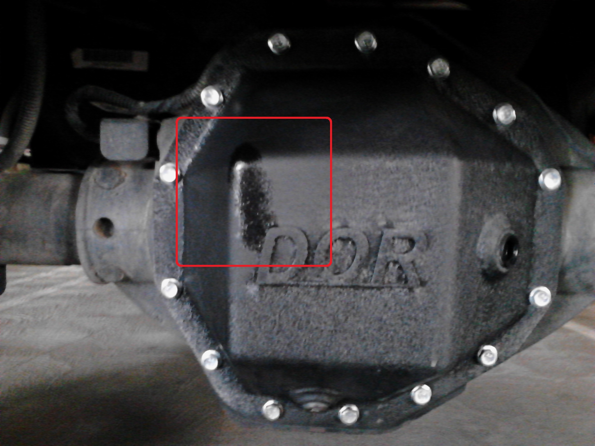

I purchased a rear DOR cover I waited 6 months to get it, when I got it one of the welds leaked, the powder-coat was peeling off, I contacted DOR for a replacement and got no response after multiple tries I gave up, so I have a $250 diff cover sitting on the shelf in my garage that I can't use.
Do yourself a favor get the DT Profab cover...
