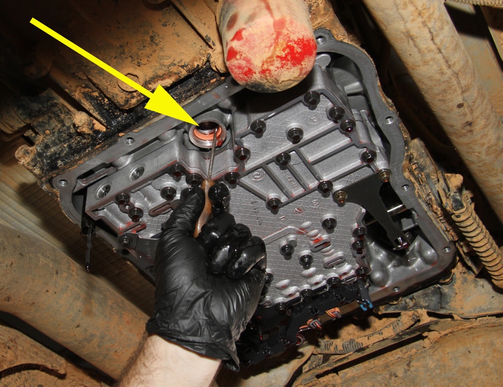

If you do it yourself, be sure to check, and remove the old sump filter seal. It will not come off when you pull the filter, you'll have to dig, pry, and cuss it to get it out.
Lol
This is an Allison transmission pic I pulled off google, same premise though.
2011

2011RPW wrote:If you do it yourself, be sure to check, and remove the old sump filter seal. It will not come off when you pull the filter, you'll have to dig, pry, and cuss it to get it out.
Lol
I did replace my seal too however the factory manual does say you can reuse the old one if it's not damaged.
