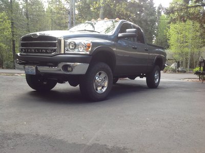

Chasing a problem
Carli steering stabilizer
Synergy track bar and upgraded bushing
Ball joints
Borgeson steering shaft
Upgrade steering linkage and tie rods
New shocks
Recent alignment
The problem is not a death wobble, but a small amount of play in something. I plan on keeping this truck since I'm the original owner with the lifetime power train warranty, but this problem is driving me crazy. Any ideas on what I'm missing? Thanks in advance for any advice...

Pwdrwgn... Maybe the feeling is coming from the extra weight of that STERLING grill you got there.
