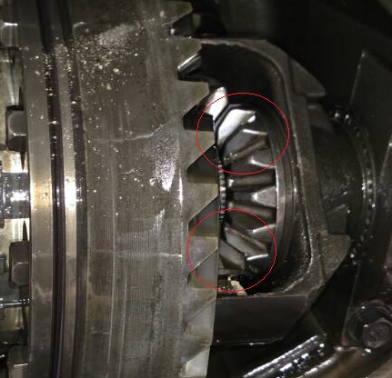

This is what caught my attention. But it maybe just light falling wrong way. Do you have better resolution pic?
Re: Bent axle
No but I'll be back in there soon, I did a quick look for carnage. No pieces in the bottom and the oil looked really good for 80k miles. Medium to light translucent grey. Nothing even close to be alarming.

I ran into a guy that has a recessed digital alignment rack with all the rigging to bend and align the solid beams on tractor trailer rigs. He says, "They don't want you bending these axle housings because it may cause it to crack with a weak spot later but if you'll sign a waiver I'll put it on the rack, I'm not responsible if it starts leaking or anything neither." Well, I dropped it off this morning and told him to give it his best shot, I've already looked into the worst case scenario and I'm willing to try this first. If he can get it close enough, I'll weld on the truss and the tubes to the housing and the last option (which I really dont want to do) is offset ball joints to correct the camber. If he doesn't completely break it, I have high hopes! I need some good luck fellas!
Re: Bent axle
Re: Bent axle
Well I thought things were looking up. Got a call from the dude, he said he got it to dead zero camber on both sides. I go to pick it up, eyeball it and it looks great. Drive across town and everything seems good, already thinking about putting the truss on it this weekend. Then, I jump on the interstate to go over an exit and when I got over 60mph, the part I feared, the ring and pinion start howling. I was thinking, pull the gears and reset them. I get back to the shop and take a closer look and the housing is cracked.
I'm pretty sure it's trashed at this point. I could weld the crack and continue but it's looking like a loosing battle.

Well, after careful consideration and reaching in my pockets I decided to finally call the insurance company. Dropping it off to them tomorrow.
Here's what finally did it in, along with the screaming gears. If the gears weren't howling, I'd weld the crack and the tubes but something is out and its a $4k risk to try anything else.
