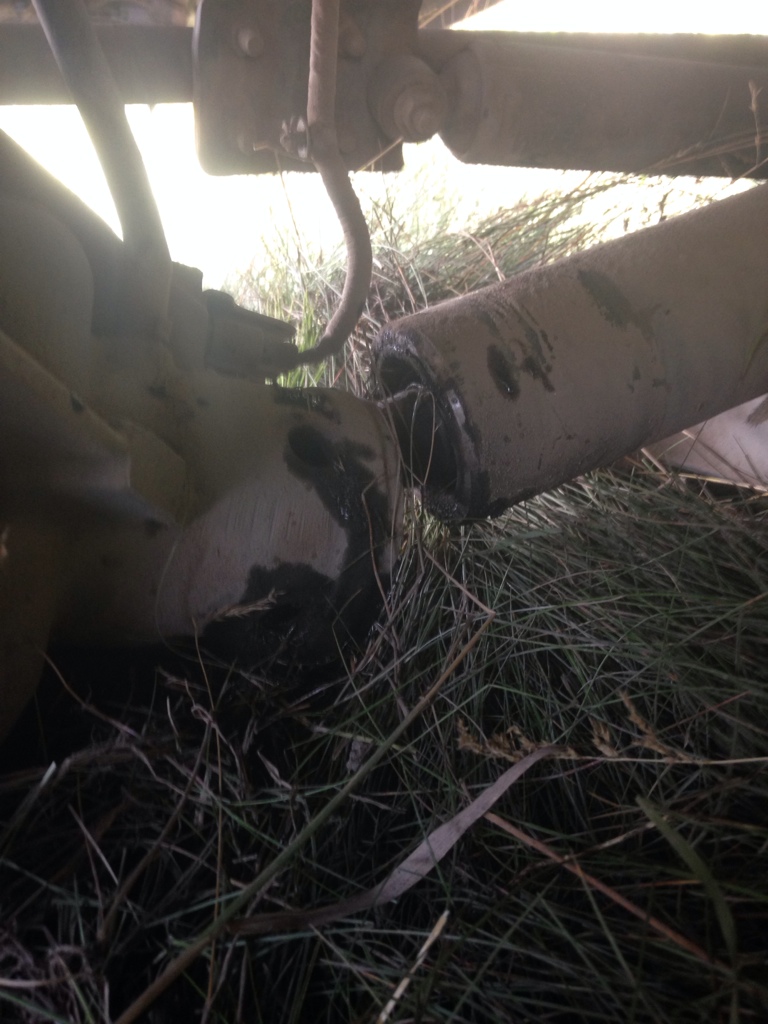

Will wrote:Anybody know of a way I can measure and check the C's? Measuring from the ground the housing isn't that far out from what I've read, I may have bent the C's also and the combination makes it worse. I dont know where the C's should be stock though.
I honestly doubt you bent a c.... I mean it's possible but they are welded properly and forged so I doubt it. Way more likely you loosened the tubes. Probably not going to have a leak with such a minimal bend because the axle seals are inboard on this diff. I hope you can find a housing! Wouldn't hurt to look into a diesel one like I suggested also as long as it is from a fourth gen it will be okay. I know it was mentioned that it shoukdnt be done because of our knuckle placement and a different caster but I don't know if that's 100% accurate on the newer trucks. Because your running aftermarket arms meant for a diesel and what not anyways...

Yep, I've been told mine is too far out to try to straighten, will have to get a new housing at the very least.

Colibri wrote:Not sure of any way to accurately measure the c's while the axle is still under the truck. Call the nearest dealership parts department with your vin number and get accurate part numbers for bare housing and complete axle then order for way less online. If you do a Thuren or Carli truss you can weld both on a complete assembly even with the axle in the truck. If you want one like mine it needs to be a bare housing and drop shipped to creative fab in California. Haha I know how it goes, breaking=upgrade time! Shit, mopar discontinued the housing for my 09, it took me months to find an axle. Good luck with whatever you decide to do man!
Well, I'm running into dead ends. The parts numbers are floating around on the web but no parts, called the dealer with my VIN and they said the assembly is no longer available. A housing for a newer, say 2012 or 2013 runs $1600 and he couldn't confirm fitment and couldn't find any in stock anywhere in their database and who knows when they will get one. I even looked into having Dynatrac build a new one but that would be mucho dinero and I would have to send them my housing to cut off the ends, coil buckets, control arm brackets etc... to reweld to new assembly.
So...who wants to buy this mother fucker? :angry: About another week of this bullshit and it will be traded in and I'll call on yall for some stock parts and strip the goodies out of it before it goes.

Get a diesel axle off eBay and get it trussed, swap your gears and locker and turn that frown upside down. I bought my rear from these guys and it went smoothly. There are quite a few others available on eBay too.

The diesel axle has a different pinion angle and no hole for the locker connector to be mounted to. I would not go that route.

Re: Bent axle
Post by Colibri » Wed May 11, 2016 3:03 pm
