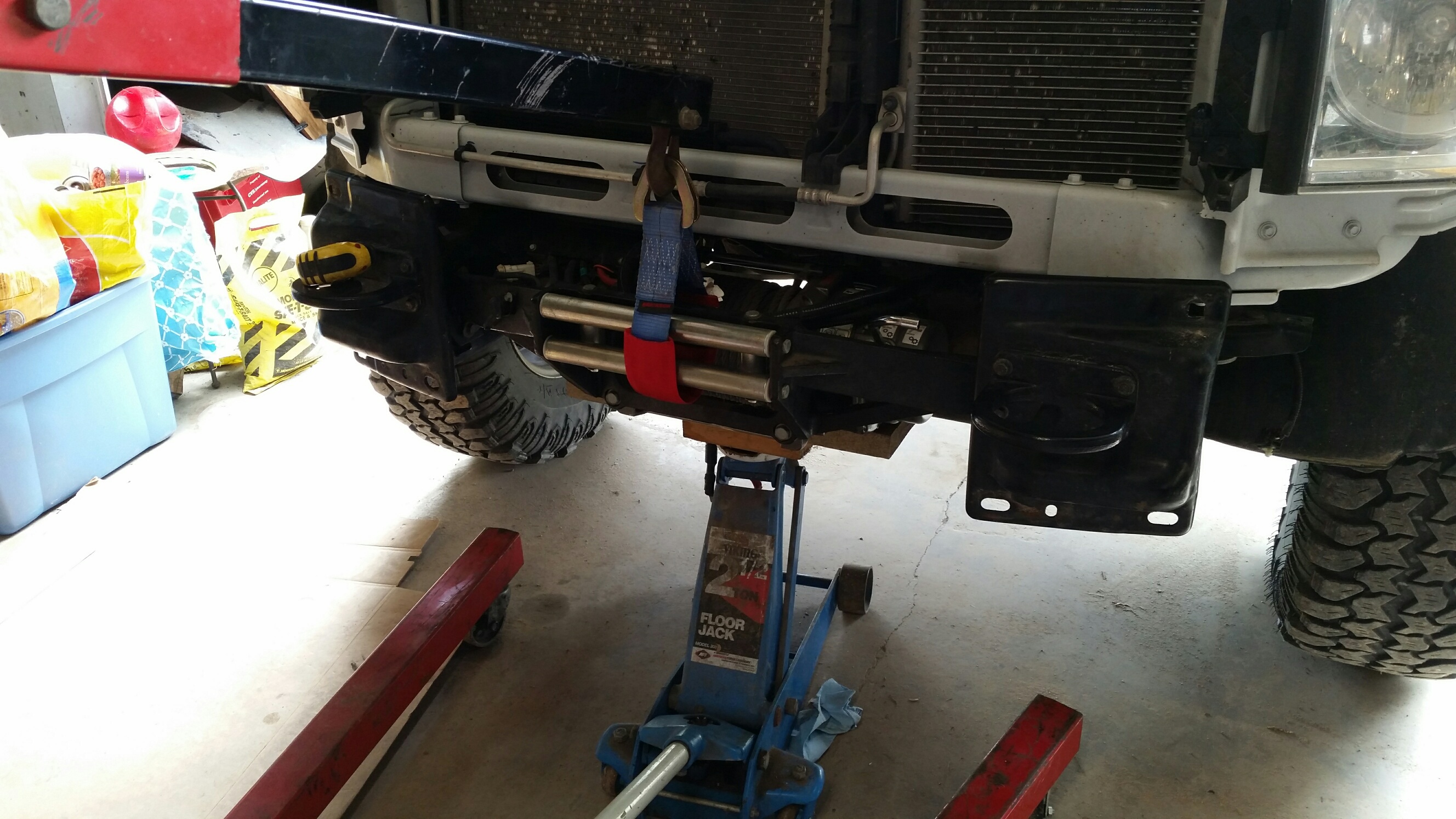

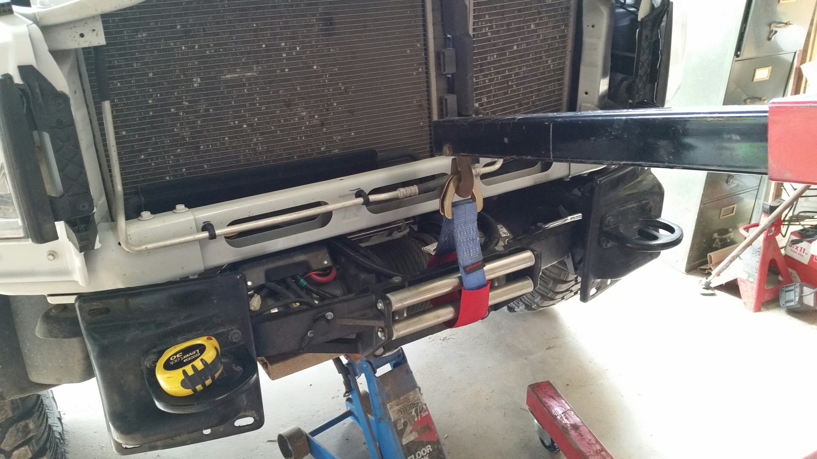

Hi all,
Update:
Fits with no modifications, you do need to remove the bumper and nicest thing the clutch lever and controller plug in are accessible from the bumper so you don't have to open the hood
Also when you go to put it in you have to raise the winch and mount higher than the bumper brackets and lower it in on a 30-45 degree angle I used a cherry picker and a floor jack

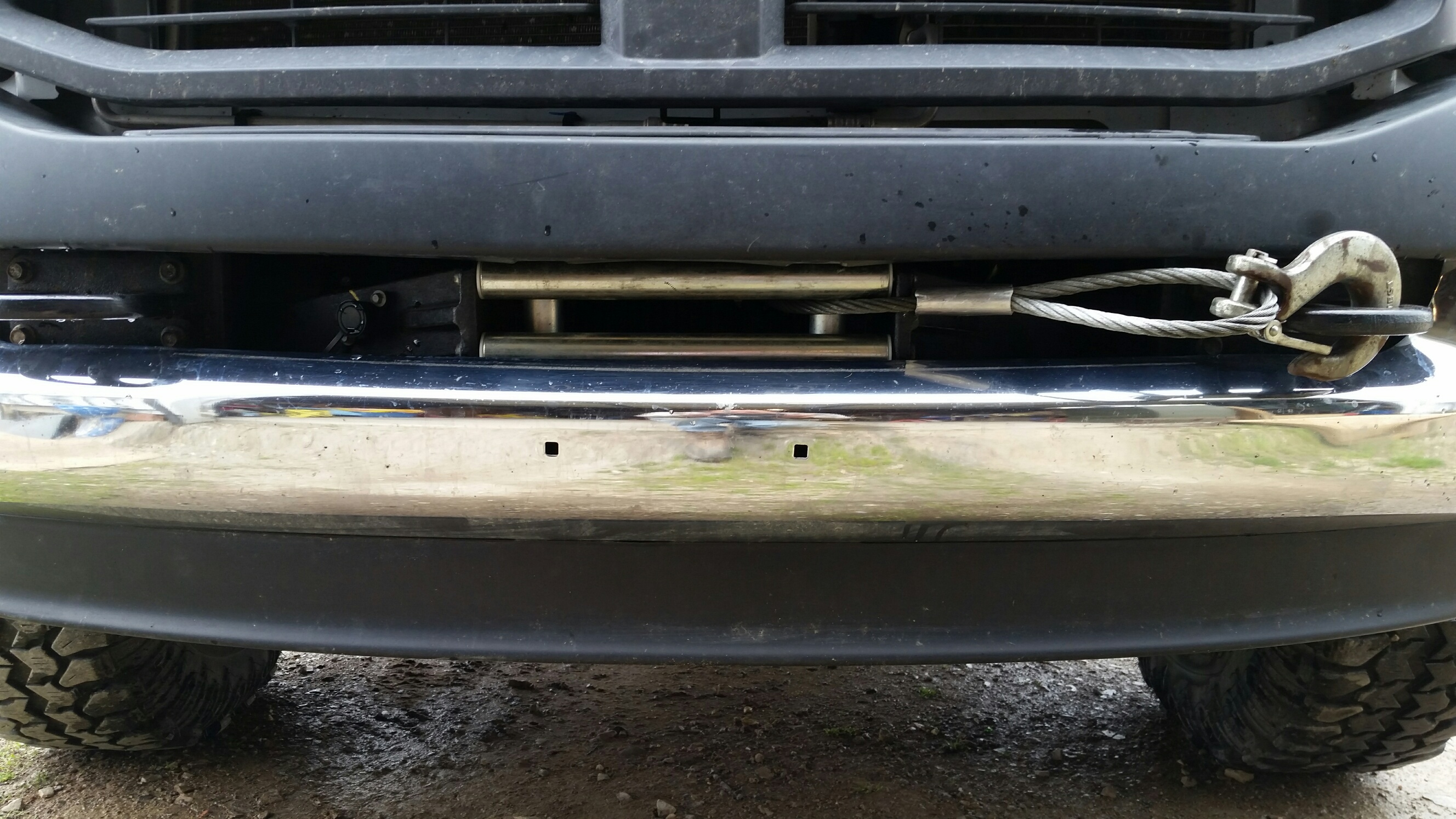

Hi,
Finally got the pictures resized so I could upload

Re: 4th gen winch on a 3rd gen truck?
Nice! Looks right at home
Yeah, wow! I cant believe the frame and bumper hole on the 3rg gens are so close to the 4th gens. Glad it worked out for ya!
Looks badass!

Hi all,
Thanks for the compliments, it a poor man's Power Wagon, one part at a time, as its a ST model, I mainly got it because it was a stick, and low mileage.
Yeah the winch fits nicely, not sure which version of winch is easier to use, but either will work in a 3rd gen
