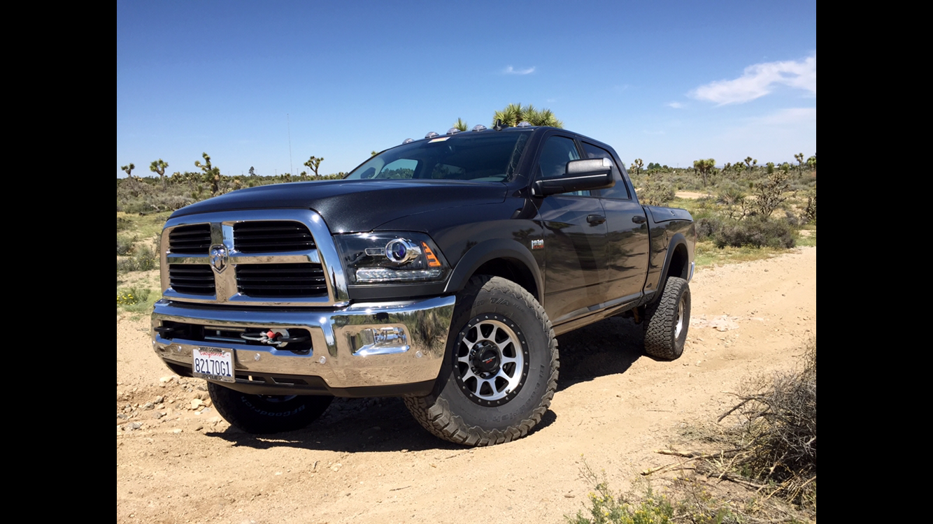

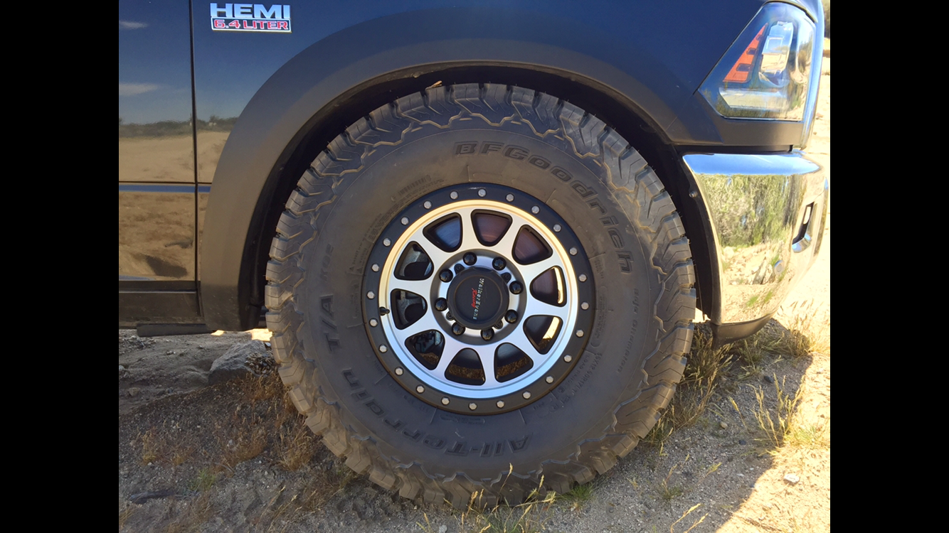

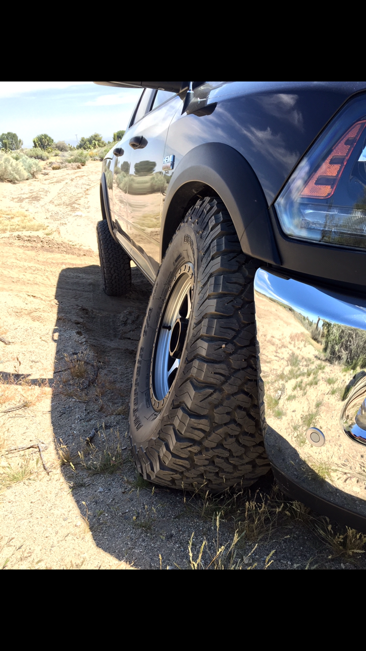

35x12.5x15 BFG KO2's on Walker Evans 504 wheels. +1 offset, no rubbing anywhere except when flexed and turning full lock, the aggressive corners on the KO2 BARELY touch the rear plastic of the wheel well. Won't be a problem with another 1,000 miles of wear, I don't have the heart to take a dremel to my baby just yet. No noticeable difference in power loss or ride quality. Seems to shift more than before, which doesn't bother me too much, and the speedo is off by about 3mph at 65 according to my phone GPS. Highway mileage improved, city suffered, just as expected. Worth it. :rockon:

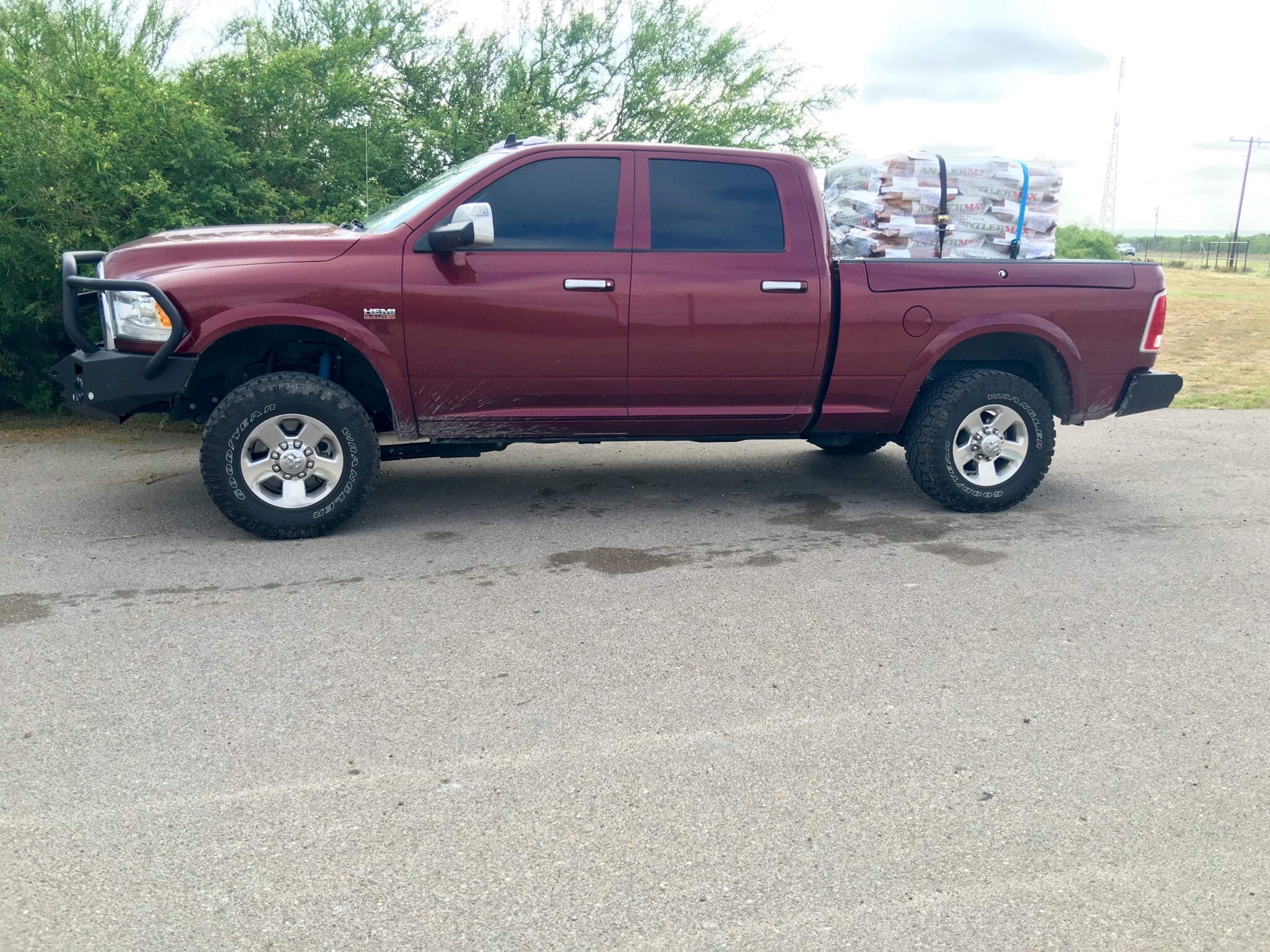

Wouldn't a 35" tire still knock your mpg down a decent bit and cause more downshifting? I want to run 35's badly but with me putting 4,500-5,000 miles a month on my truck I can't kill my current 12.4 mpg overall average.
A lot depends on WHICH 35" tire you go with. Wider, heavier, knobbier tires make for worse rolling resistance, which will reduce MPG. If you go with a mellow 35" tire (like a Yokahama AT or something) you will most likely not notice too much of difference. Go with a wide mud tire that weighs a ton, then yeah you will surely kill some MPG.
So I guess a 35" Toyo MT would be in that NOT good mpg category. I wonder how bad a 285/75r17 Toyo MT would do, I love that tire. I definitely want to go with a E rated tire due to me hauling a ton of feed in the bed several times a month.
