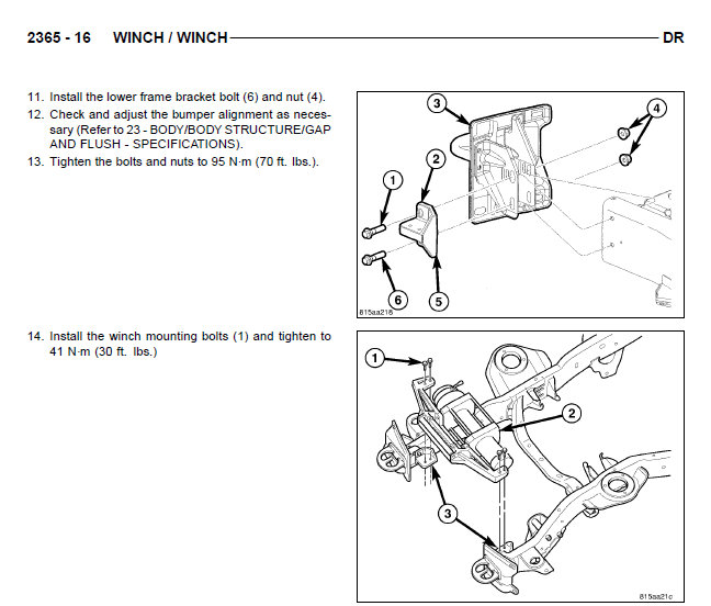

I don't know how a 4G winch mounts up, but this is how the winch and cradle mount on a 3G ...

That sure looks the same ... Hard to tell though if it's the samecruz wrote:I don't know how a 4G winch mounts up, but this is how the winch and cradle mount on a 3G ...

The winch should work fine, although maybe in needs to be flipped? The mount on the other hand, that probably wont work. Im sure the frames are different.

Just looked and my '12 mounts the same way as pictured above

If the frames are the same, the mount bracket should fit ...
- Posts: 5564
Re: 4th gen winch on a 3rd gen?
If the brackets looks the same. Measure the distance across where it mounts to the frame. On both a 3G, 4G, and a 4.5G.
