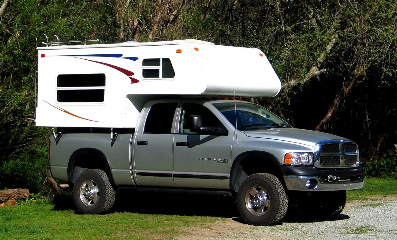

I have been thinking the same thing for when I load up the truck camper. It would be nice to have the articulation when not loaded/in tow but the sag is a drag with a camper. looking at the firestone airbags at this point in time myself. stiffer rear end when needed would be good.

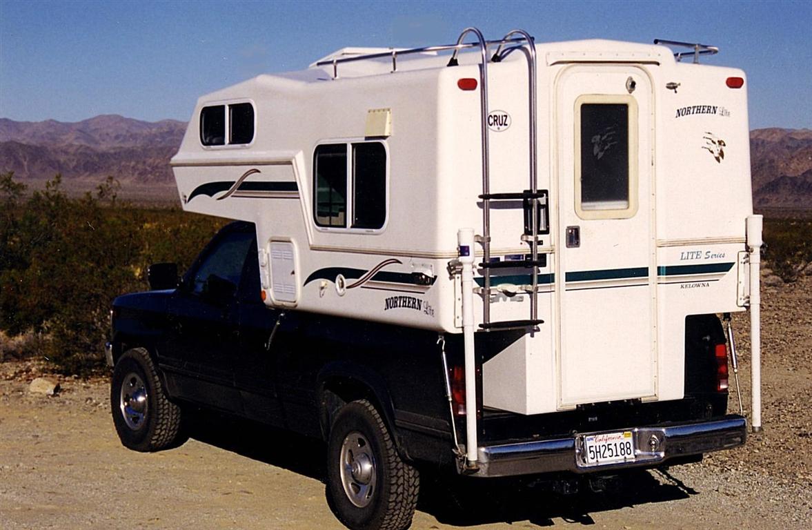

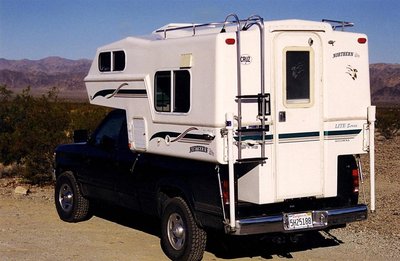

I've bought and installed 3 sets of Air-Lift brand airbags on my last 3 trucks ( '92 FORD Ranger SuperCab STX 4x4, '96 Dakota Club Cab 4x4 and my '05 Power Wagon ) to help carry my campers.
Here is my two cents...
1. Air bags DO NOT increase payload !
2. They work great for leveling and reducing sway
3. At $200 for the Ranger, $240 for the Dakota and $277 for the PW they are reasonably priced.
4. Not one of the three sets have EVER FAILED.
5. All my campers have been light weight , well under the max. payload of each truck. I used them to level out the ride but more importantly to control sway from left to right.
6. When my truck is empty and the air bags @ 5 lbs. ( the minimum psi ) it rides very, very close to stock.

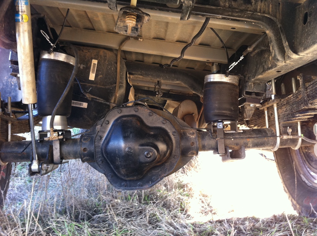

This is My opinion on the Carli LT Air Bag.Cactus Red wrote:Maybe BajaXplorer will see this and give you his experience with the Carli's. He's already had two bags fail in the last couple years. And they ain't cheap!pzoeller wrote:Air bags???
Damn expensive...
but more importantly to me is the inboard mounting location. For me, when hauling my slide-in camper, controling left to right sway produced by a higher center of gravity is job 1 and IMO the Carli's lose leverage due to their location on the axle.
