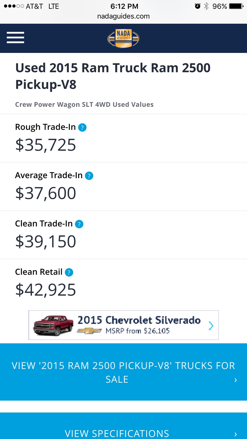

Here's what nadaguides.com has to say about the value:
Looks like a great deal if everything works...

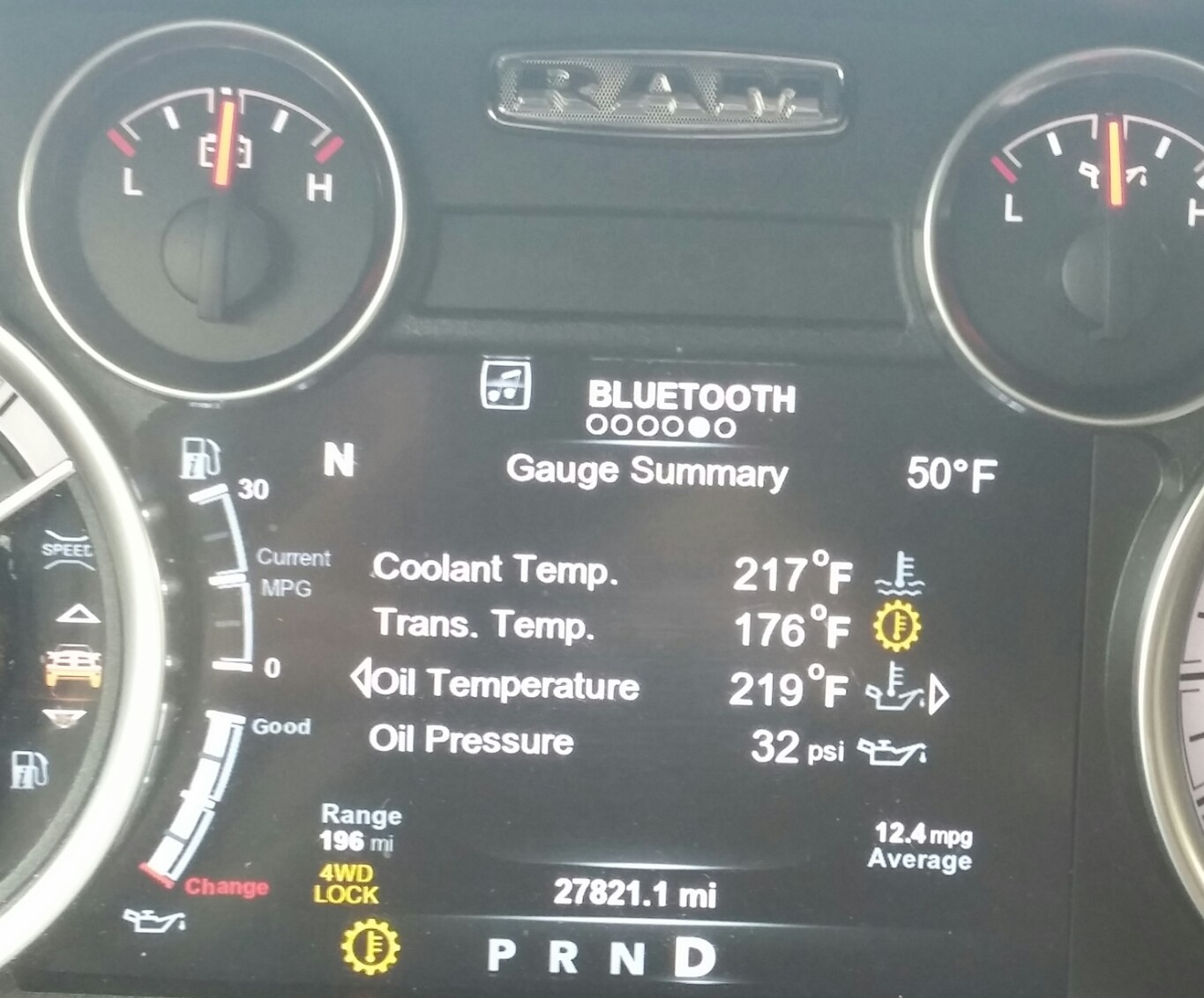

Thank you all for the replies. It's weird, I've been lurking on here so long, actually getting replies and from posters I recognize is trippy. Well I went back, and checked everything that was mentioned. It all looked great. And hearing multiple people justify the mileage was all the motivation I needed. So I brought that sexy bitch home last night. I all but spent the night in it. I'm in L-word with this truck. That's right, I Lesbians this truck. :lol:
Today after work I jumped in, and decided to go play in the desert near my house where there is sand and lava rocks galore (Petroglyph National Monument). Mostly I was in 2wd just appreciating finally having an lsd. I finally came to a decent hill with sand and basketball-sized rocks scattered that actually called for 4wd. So, 4hi, not lockers, sway bar disconnected. 30 seconds in, my dash lights up like a X-mas tree telling me "Transmission Too Hot". The gauge only read 190 trans temp though, which seems within normal limits to me. I ease it the rest of way, disengage 4wd, park, and crawl underneath. I found what is to me at least, a leak big enough to be taken very seriously. See pictures. The pictures were taken just now, and do not look quite as bad as when I first looked. There are also drips on my driveway that I am certain were not there this morning. Anyways, I limped to Carmax with the temp fluctuating between 166 to 170 the whole way where being 5:15, no techs were available for comment. The other staff was kind enough to make me an appointment at my local Ram dealer to drop the truck off in the AM. So I will be walking in at 0800 with my CarMax 30 day warranty, and my 36K mile warranty to politely ask what the fuck is up. Why is my transmission leaking? Why is it running so hot under such a light work load that I'm getting warnings? And since I'm paranoid now, I noticed what seems like a lot of fore and aft movement in the 4wd shifter when I accelrate. Its been so long since I had one on the floor I don't remember what normal looks like. We'll see what happens. Worst case, it was fun while it lasted. :chug: Any of you PW veterans have any insight?

Post by olyelr » Fri Mar 04, 2016 10:59 pm
Well dangit already.
That looks like motor oil to me, not trans fluid.
Also, 160 to 170 is what i would call normal operating temps. Almost sounds cold actually.
But regardless leaking oil and a dash lit up is certainly a big red flag this early in the game.
Best of luck!

Definitely looks like motor oil the mopar ATF +4 tranny fluid is very red, you are still covered under the factory warranty so I wouldn't worry they will get it taken care of....

Well...the fluid is almost certainly motor oil. I took a look this morning with better light, and it's definitely not transmission fluid. Transmission fluid after warming it up and shifting through 4 hi and lo was nice and full. Engine oil was actually a good inch over the full line. On the way to the dealer I decided to verify what I saw yesterday so I found a dirt hill and went up it in 2wd, 4hi, and 4low. Then once more in 4hi trying to duplicate my driving yesterday. Sure enough when I tried going super slow until the nannies kicked in and then trying to fight them, I got the same warning. This time at 176 degrees (picture).
I'm also getting a little paranoid about the amount of movement in the floor shifter when I accelerate. I expect a little, but it seems to be punching to the rear of the vehicle by at least an inch every time I hit the gas.
So I just dropped it at the Dodge dealer. They echoed that it should all be covered either under the manufacturer warranty or CarMax's. To me it sounds like multiple problems. Whatever is letting motor oil leak down and pool on the transmission, and the temperature sensor on the transmission. But I've waited years to get a PW, I can wait a little longer. I'll keep y'all updated.

There should be no warning @176 for a transmission. I have my Areoforce gauge set to alert me at 200 and even that is not too hot. I think the factory idiot light for the transmission in my 3G sets off at 220. Your water temp is a bit high but not overheating yet. Something odd is going on for sure. A reflash might fix it.
See the chart
http://www.txchange.com/heatchrt.htm
Are you sure the alarms aren't due to the traction and stability control not being happy?
IMHO The highest safe temperature for your transmission is 200 degrees. I was taught that for every 20 degrees past 200, the lifespan of your transmission is reduced by a factor of 2. In other words, if you hit 220 degrees, you can expect to get about half the normal life out of your transmission. At 240 degrees, your transmission will last about 1/4 the time that it should. And if you get up to 260 degrees, you are down to 1/8 the normal life.
