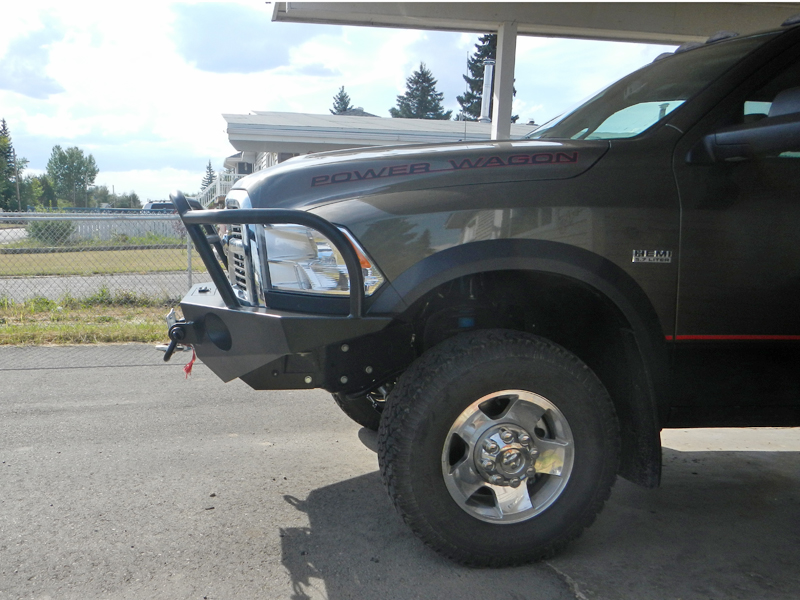

Anyone seen the thunderstruck? They make this bumper power wagon specific for all years . They just cut a slot for the factory winch, just need a new fairlead...

Gnarly for sure but looks heavy.

That Thuren setup looks pretty hot! Any updates???
Re: Let's talk bumpers
Maybe as early as a week he will be able to confirm whether or not it will work on the PW or need to be redesigned. Hopefully just cut a slot and add a fairlead.

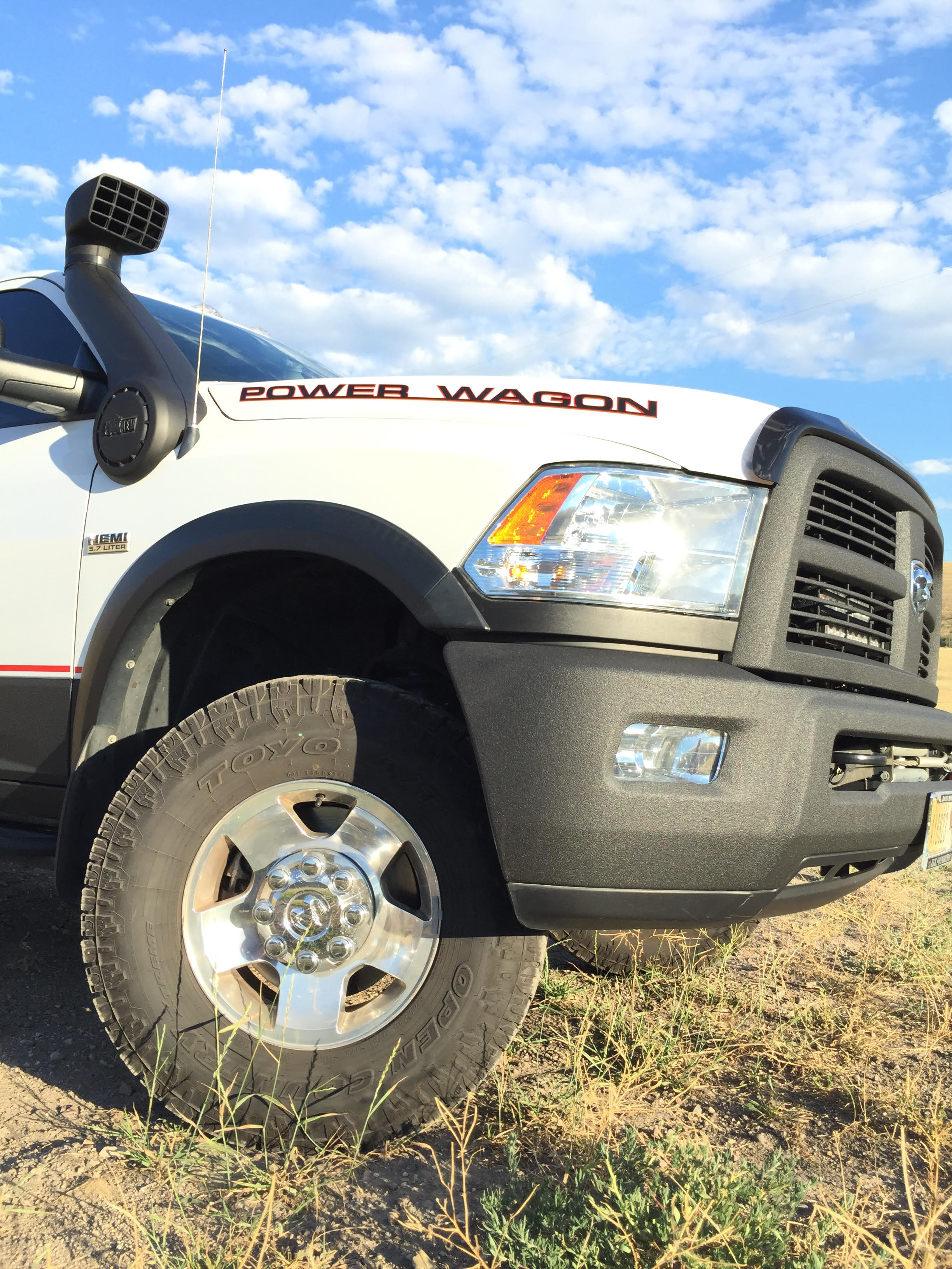

So I keep going back to the Aluminess Bumper as one of our best options. However, I have one concern I was hoping others could help me with. I live in an area that gets snow and ice, and they put deicer and crap on the road. I'm not worried about the integrity of the bumper because I'd have it coated with Line-X. However, what concerns me is the lack of coverage where the sides angle up. I fear that the way the Aluminess Bumper is cut it takes away from some of the protection the factory bumper gives when it comes to weather conditions. I'm thinking things like the smart bar, shocks, wires, etc are more exposed than the factory bumper. Any thoughts on this? For reference here's a side shot of the Aluminess and a side shot of my truck to show what I'm talking about.

Juday thank you for the pictures. It doesn't appear that the Smart Bar is any more vulnerable with the Aluminess versus the stock bumper. This is a HUGE help!
No problem! Keep in mind, too, that I trimmed those fender wells myself. You can cut them, or not cut them. I opted to because I like the clean look. In regards to exposed electronics, I just spray everything down well with Fluid Film and call it good.04Ram2500Hemi wrote:Juday thank you for the pictures. It doesn't appear that the Smart Bar is any more vulnerable with the Aluminess versus the stock bumper. This is a HUGE help!

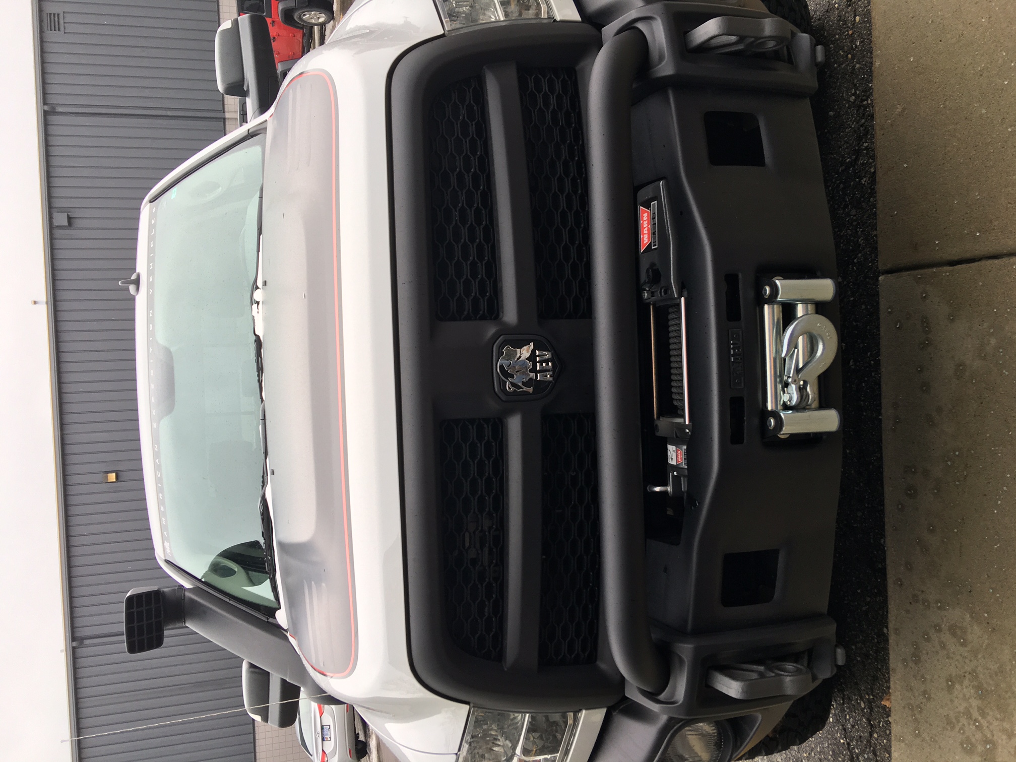

AEV Bumper installed pics
Here are pics of the AEV CFO's Prospector Ram's bumper. The mounted total weight is 300-320lbs depending on options.

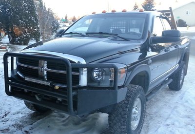

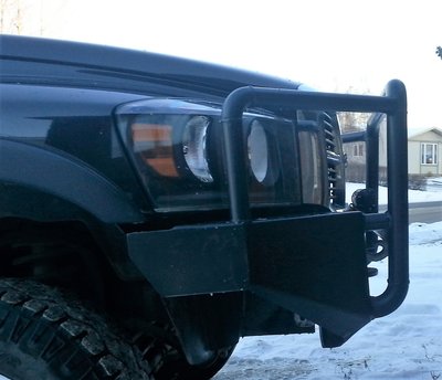

Probably a lot cheaper ...Trouble Maker wrote:My own creation.
- Trouble Maker
- Posts: 157
- Location: Lloydminster, SK
Other than the lights all I bought was the fittings to make the grill and light guards from. All material is 3/16" or 1/4" plate. Without the guard it sticks out the same as the factory tow hooks which I reused and it mounts with the factory hardware. Winch is on factory carrier in factory position. Still needs a few touch ups but I plan on pulling it off in the spring to blast and coat and will catch everything then.adeluca73 wrote:Probably a lot cheaper ...Trouble Maker wrote:My own creation.
