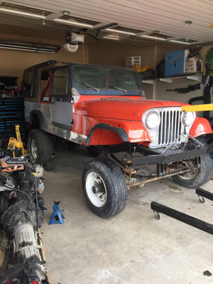

Will wrote:I have never even looked at the door sticker, I load it down and let it eat. This isn't a heavy load but I had about 400# in the bed and hauled this 18' dual axle with a 250 gal lp tank and this old Scrambler yesterday. No problem at all getting up to speed and easily held 75mph on the interstate and averaged 11.7mpg.
Sweet scrambler Will!! Is it yours?

The Scrambler is not "technically mine yet" :lol: My best friend inherited it but he doesn't know or want to know anything about engines and such so I'm going to try to adopt it :D . He's the type to drive a truck and never have it serviced unless something breaks and then drive it until it breaks beyond repair. He's not even interested in the Scrambler and told me to take it home and get it running. I had to nurse the battery back to life and disassemble the fuel pump, clean it out, drop the tank, clean it out, new fuel filter and got it to fire up. The carb is leaking gas from every possible location so I'm going to pull it and rebuild it then go from there.
