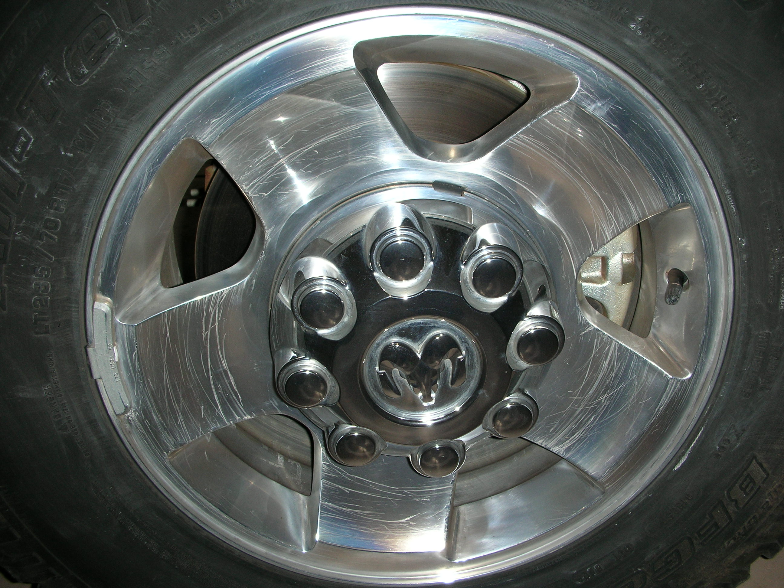

I recently got stuck and the mud was up to the frame. I had to winch out and the mud was so deep I needed to spin the tires while winching. I scratched one wheel up very bad from spinning in the rocks. Its a 2013 truck. Is there any way to repair the wheel.

Hard to tell wihtout seeing any pics of the scratches. Sometimes polish is enough to lessen or clean up hairline scratches.

Ya its pretty much ruined it took all the finish off and its only on one wheel. Some are very deep.

You can repair scratches to forged aluminum wheels, but you'll go through the clear coat to do it and it's a lot of work. Might be easier to just live with it. It is a Power Wagon, and you earned those scratches doing Power Wagon stuff, after all.

Just spray it with Plasti Dip, that's what I did

Google for a wheel repair shop in your area they can usually fix most types of damage including sand, polish and new clear coat for a lot less than a new wheel.

That sucks, let's see the damage...
Re: damaged wheels
I ended up sanding the rim with 1500 grit and polishing it with a drill, Looks a lot better except for a few deep scratches. It really brought the shine back.

Looks way better than it did before sanding and polishing but it still has some deep scratches. Im going to wet sand it again and polish it. I think I can make it a little better. I use the truck for what it was intended for. Stuff like this is going to happen.

oh yes, that's about what mine looked like.

I don't have a wheel shop close. Im going to wet sand again, polish, then wax. I think I can get it a little better than it is now. I wish I took a before picture because the wheel looked horrible. It was completely dull.
