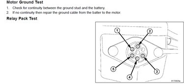

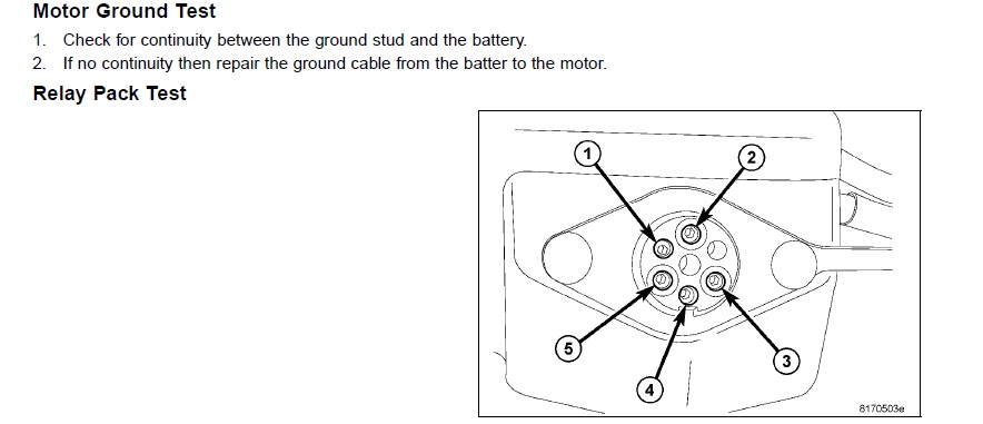

My winch hasn't been working for a while and was doing a little testing and noticed one of the metal sleeves inside the relay pack where the controller plugs in pulled out and was stuck to one of the prongs on the controller plug, #2 in the picture. Looking in the tech manual it says the whole winch needs to be pulled to replace the relay pack. Does anyone know if there is a way to fix that one metal sleeve without replacing the entire relay pack? Thanks for the help.
Re: Winch Relay Pack Removal
The answer is yes you can just replace the socket
see link below
http://www.amazon.com/Warn-39886-WARN-S ... B000CQBM3Q
