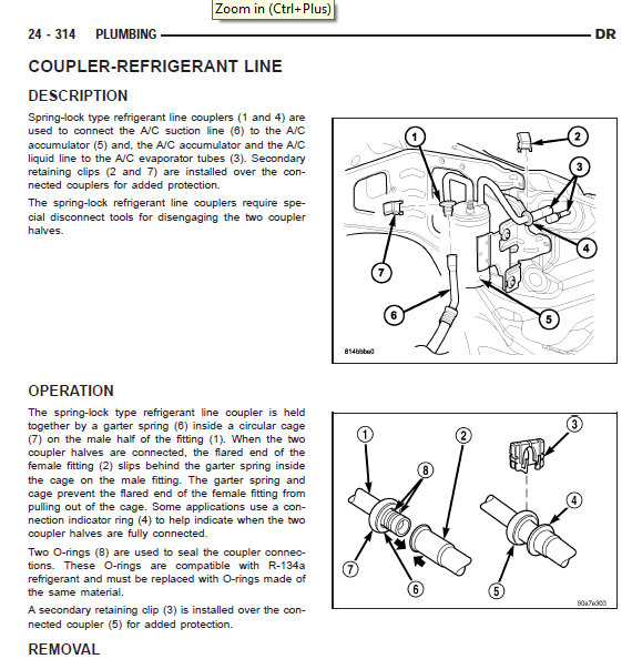

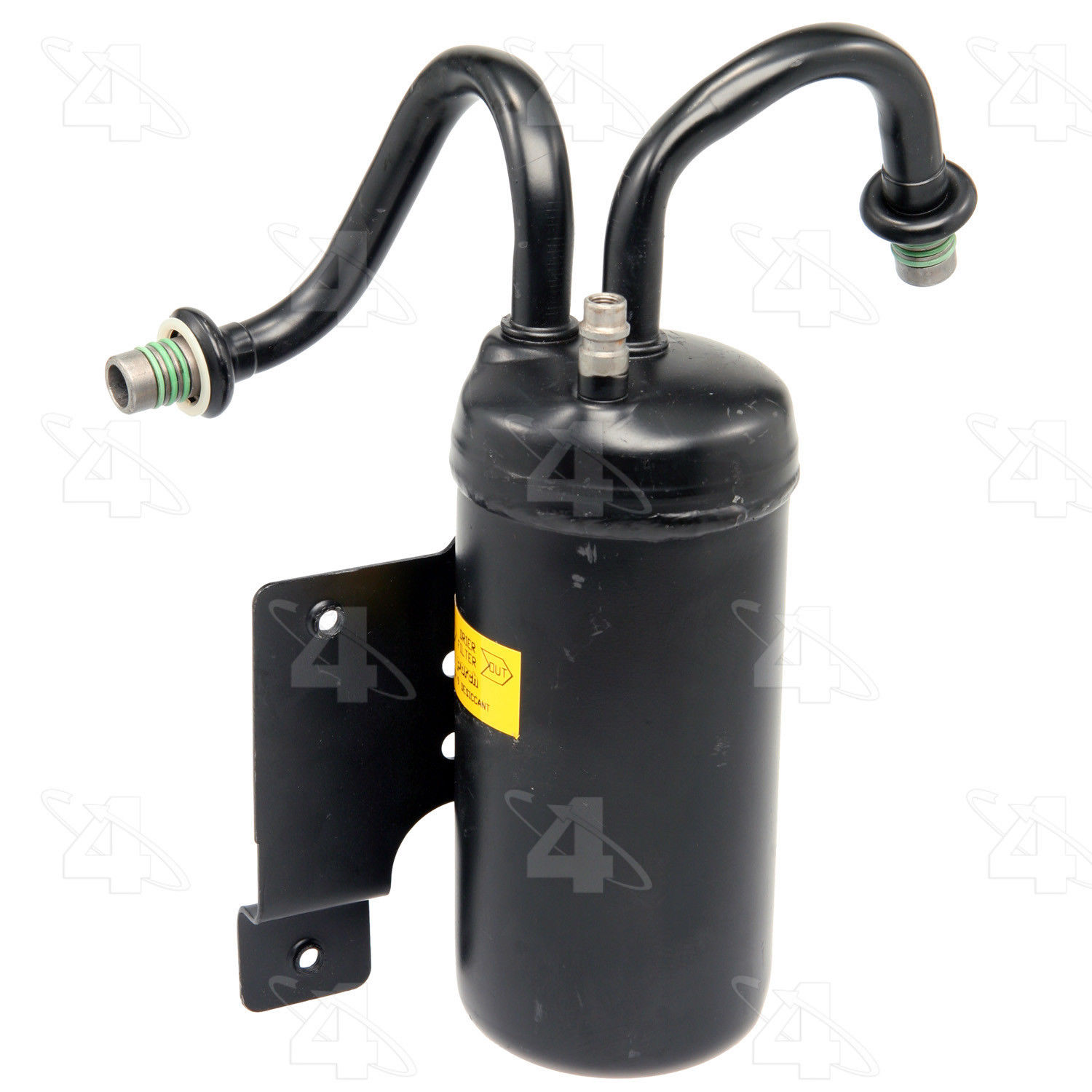

I will be replacing my ac accumulator but can't tell what kind of tool is needed to remove the fittings anyone done this before any suggestions?
- Posts: 5569
Re: 3G A/C Accumulator Removal
You need a spring lock coupling tool.
