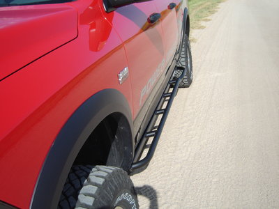

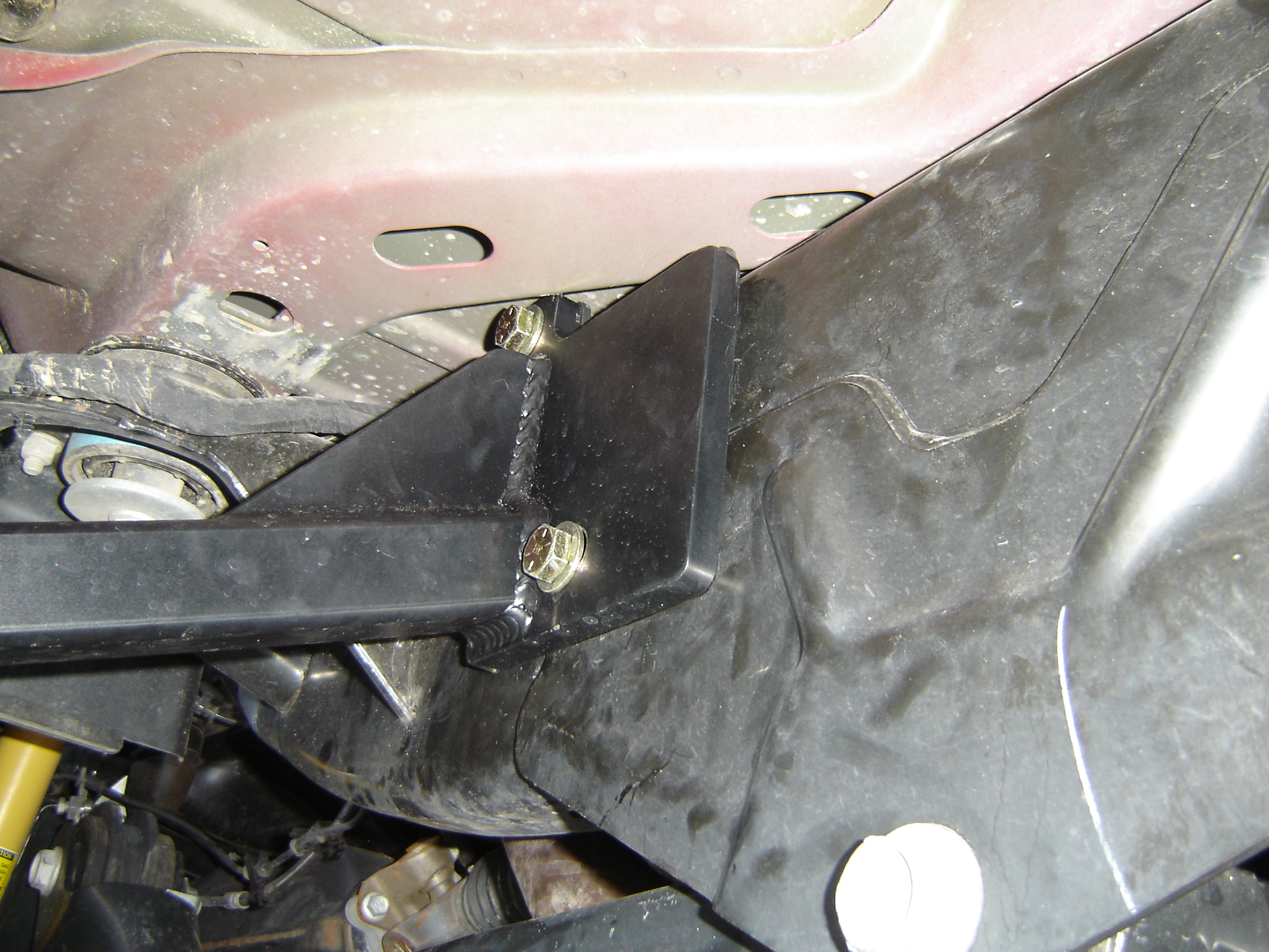

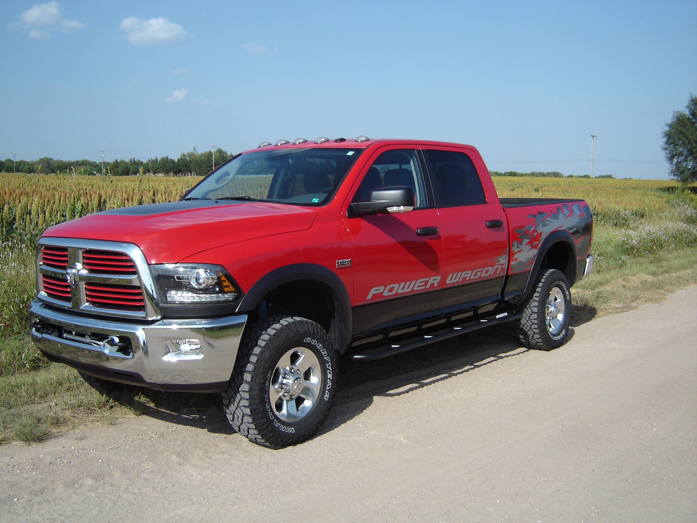

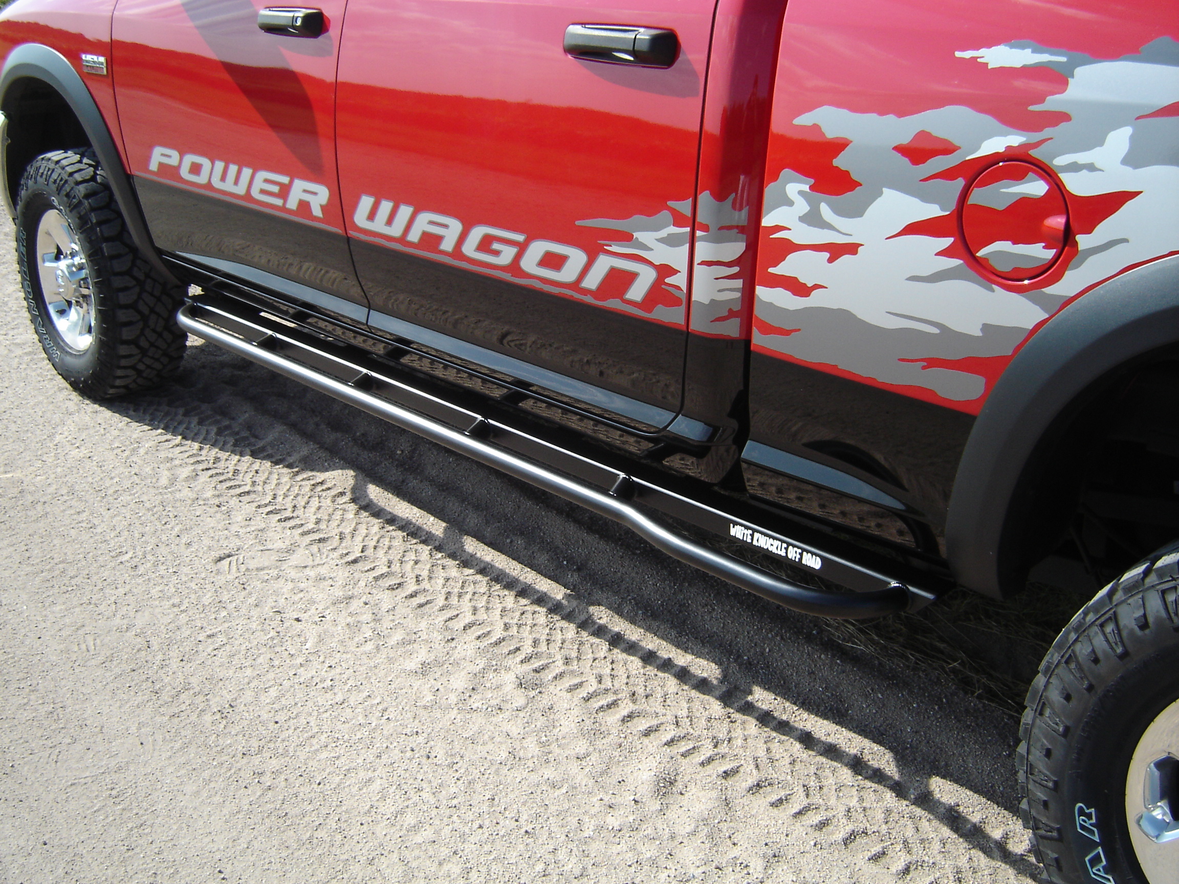

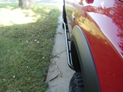

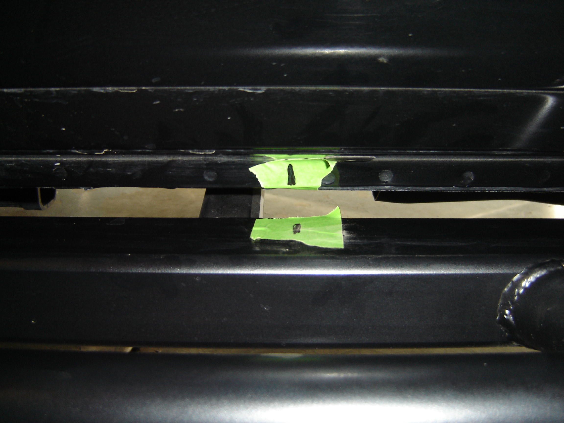

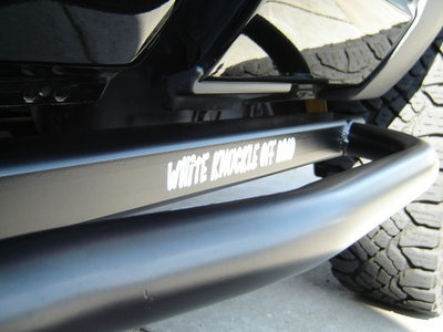

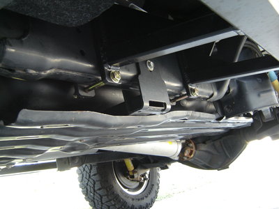

I received my WhiteKnuckle Sliders Friday for my 2014 and installed them. I have to say that I was very impressed with the shipping and packaging and overall quality of the product. The sliders arrived as ordered with all the brackets clearly marked and the hardware was exact and good quality. The installation on my 14' was a bit much especially with no help. I installed them on my own and the front mounting bracket requires two shims to be installed bewteen the frame and brackets. It was tough by myself. It also seemed like the instructions were written for a 2500 and not a powerwagon. I had to remove the gas tank skid plate to install the rear mount. That was not outlined in the instructions. Also found it useful to remove the storage bins in the floor boards. It took seven weeks to get them once they were ordered but they look good and are very strong. I ordered the 0.120 wall DOM set powder coated. $1350 total.
Shows how much of a step it can be
Mounting locations
Front mounting bracket with shims on both sides of Frame
4th and rear positions showing tight fit with tank skid plate installed.

There are a few other tips. Like Low Sky suggested the parking brake issue and the wiring harness retainer clip issue need to be followed. Both of those are outlined in the instructions given by WhiteKnuckle. Also, both sliders came with one shorter bolt than the others. All mounting bolts were 5 inches long and then one 4.5" bolt. The parts list and instructions did not list this. However, It was obvious that this bolt was for the floor board storage compartments. The #4 position fits just inside the storage compartment and the longer bolts will interfere with the compartment wall.
The instructions also state to line up the sliders in the middle of the truck but it is hard to tell where that is. So I marked the center of the truck and center of the sliders and lined up the marks. The instructions stated to hold the sliders with floor stands but I found it easier to balance the sliders on my floor jack and move them into position that way.
Working by myself it took about three hours. But I'm not a fast worker. (easily distracted)

How are them bad boys working out for you? I've got mine off right now and JB and I are doing some mods, heavier expanded metal to fill in the gaps for rock chip protection and extending the step grip. Funny, his mounts are exactly what they came up with except for the shim. He actually welded in a plate and smoothed it out to correct the offset, which is a better design in my opinion, shims are a cheap fix for an unexpected problem. Although if white knuckle had them out I probably would have bought them, but, I do like the fact that mine are made to exactly my specs and look I want, at $800. Maybe I rubbed that in a little lol. All in fun. I do like them and they look sweet on your truck. Its amazing how much braver you will get once you have solid protection and an actual full skid plate from side to side.
