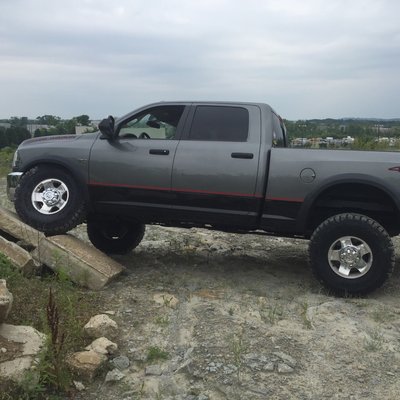

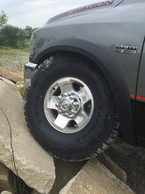

I am really itching to do 37s... Do you have some pics you could share? Have you tired it off road? They need to work when stuffed into the fender wells for meJack187 wrote:I'm running 37" pros right now on my 2015 with no lift. Pretty sure you will be fine with the 315s on any of the 4Gs, regardless of the suspension.redneck1 wrote:Hey guys fixin to get some new cooper stt pro mud tires and wondering what's the largest size we can put on a stock 4th gen?? Hopin to get 315/70/17 wich is 34.5s thanks

I'm running 37s as well with some rub. Nothing bad. I also have a Diablo tuner

I am also running 37's with stock wheels and stock arms. Minor rubbing but it's not a deal breaker.

My 37's rub a little on the upper control arms, but the worst part is how much they rub on the sway bar ... Damn near shudders the truck apart ... I'm looking into some options to fix the issue
