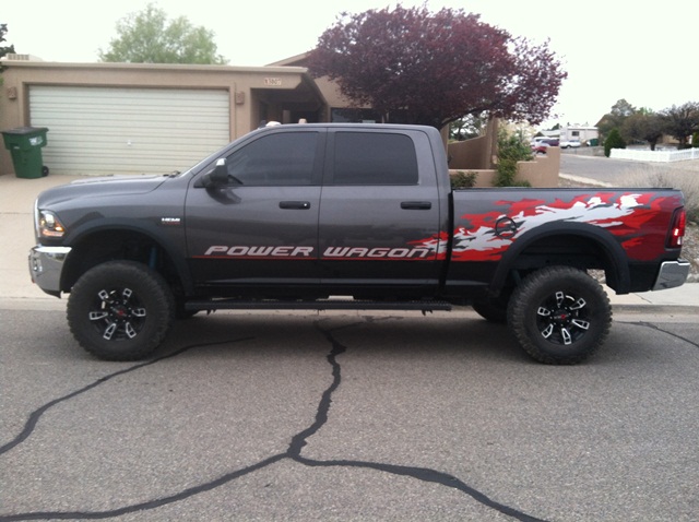

Finally got around to getting my leveling kit installed , after mths of looking for a manufacture of a kit for the 2015 pw I ended up getting a 1.5" kit custom made for my pw by truxxx.com . very good quality part,s before level truck measured to the top of the wheel wells was 44" back , 41" front , after the level kit its now 44" rear and 43" front . sits perfect with still a minor rake that I wanted for payload . Boss air bags are going in soon . Got 100 plus kms on the kit so far truck rides as smooth as stock and handles great .
before kit
after level
Install was simple with proper tools had to disconnect sway bar end links , trac bar bolt , and shocks . use to jack to evenly lower the front axle a buddy helps for this , install the spacers and shock extensions .

Any change in drive, suspension travel, articulation, caster, toe-in, alignment ? Did you have an alignment done after?

I have not taken the truck for an alignment as of yet , it drives perfectly fine honestly don't notice any difference . I think the 1.5" is just enough where I still have 1" of rake and it does not make a huge difference where it would need to be realigned , if this were a cv axel and not a solid axle I would get it aligned right away . but in saying that I am getting a set of 35x12.5x17 bfg ko2's soon and I will be putting there on an aftermarket wheel ( was going to stick them on the stock wheels but the stock wheels are only 8" wide and bfg recommends a 8.5-11" wheel for these tires ) , while I am at the garage I am planning on getting them to check the alignment just to be safe .

With the cross over steering, there is really no alignment needed with a leveling kit. The caster is going to be off a bit, but there is not really any way to adjust that unless you get aftermarket radius arms (or some type of drop bracket on the axle that adjusts it (like AEV's kit). Your steering wheel should have been off center a little though after the level. Did you have to recenter it?
2015powerwagon wrote:... I am getting a set of 35x12.5x17 bfg ko2's soon and I will be putting there on an aftermarket wheel ( was going to stick them on the stock wheels but the stock wheels are only 8" wide and bfg recommends a 8.5-11" wheel for these tires )
I have been running 35x12.5x17 BFG KM2's on my stock Jeep wheels which are only 7.5" wide and have had absolutely no issues. They are wearing perfectly. But, most large tire shops (like Discount Tire) will not mount them due to all the legal bullshit. I had to find a smaller local type place to have them mounted up.

As long as longer shocks are installed or extension brackets are used there really isn't any loss in articulation to speak of.

I have no issues at all with articulation, tire wear or any other BS. The only thing I can feel is a very slight amount of bump steer, again very slight. Mine sat to level so I added the 1" in the rear and like it. I don't have any issues loading the truck down. My goal is also to run some 37" tires eventually.

Yeah, the truxx kit is fine. I have run it in Moab on some tough trails and use my truck for daily driving/towing. The traxda in the rear has never given me an issue either. If it was junk, I wouldn't run it and the shock extension is the secret to keeping the articulation. I think some people put way to much thought into things sometimes and over think or over engineer in their mind what works and what doesn't. I am normal guy that likes to play hard and kill animals to. I only buy or use stuff that works and make sure I install it correctly. If it doesn't do as it is supposed to, I will immediately take it off and send it back and shop for a better product. I have no reservations saying these 2 items with 35" tires will fit the bill for what you want to do and more. BTW, there is no shock extension in the rear for the 1" spacer. I just live with the small loss of articulation (1")in sacrifice for a level truck when the bed is loaded or a trailer is hooked up. Never noticed a difference off road.
