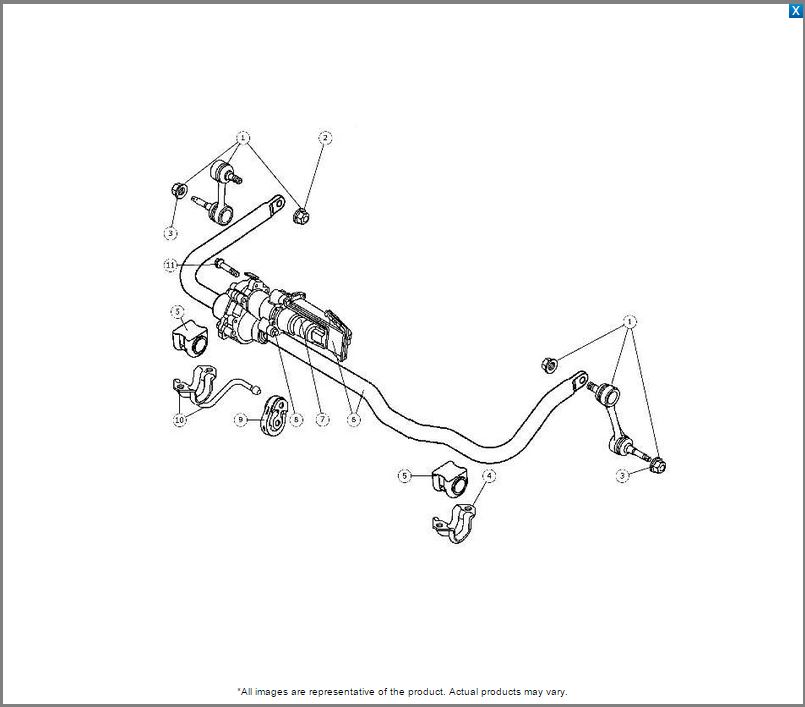

I think I found part number for end links, V5175052AB. I found them on this website: http://www.moparpartsoverstock.com/p/__ ... 052AB.html in the details it says 'front swaybar with disconnect' Problem is, I am going on a trip this weekend and need them ASAP. I've never ordered from this site before, anyone have any experience with this site? Fast shipping? Or does anyone know of any stores that sells the power wagon end links?

Whoops, forgot to add the link:
http://www.oreillyauto.com/site/c/detai ... r+bar+link
I looked at all the 2500 end links on the site until I found this one.

The end links on the pw swaybar is completely different than every other ram. They have upper and lower ball joints and are not adjustable. The best bet would be buying the through a dealer as I don't know if they are available at all aftermarket. Your best bet might be to talk to don thuren and ask him what he can you set up with for end links

Better yet, I printed out the exploded view and the part number and am going to stop by the dealership after work to order the end links in person. I will keep you guys updated.

Well, stopped by the dealership yesterday. Apparently the V5175052AB part number is for a 'value line' end link and these parts are currently not available. The guy proceeded to look up the non-value line ones and he came back with that $230 per link price (same dead end road that dodgeman found). Even with my Chrysler employee discount it ended up being $194 per link. I told the guy "no thanks" turned around and left. I am dumbfounded those things are marked up that much. Looks like I will be ordering the DTprofab end links: http://www.dtprofab.com/DTP02043-PowerW ... p_313.html
