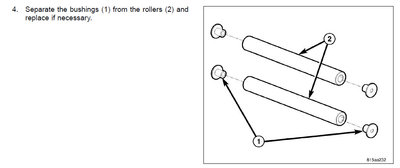

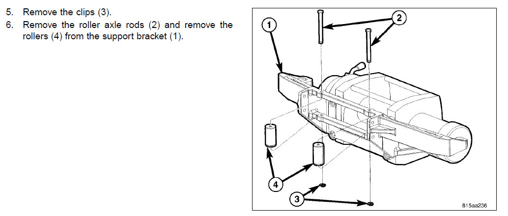

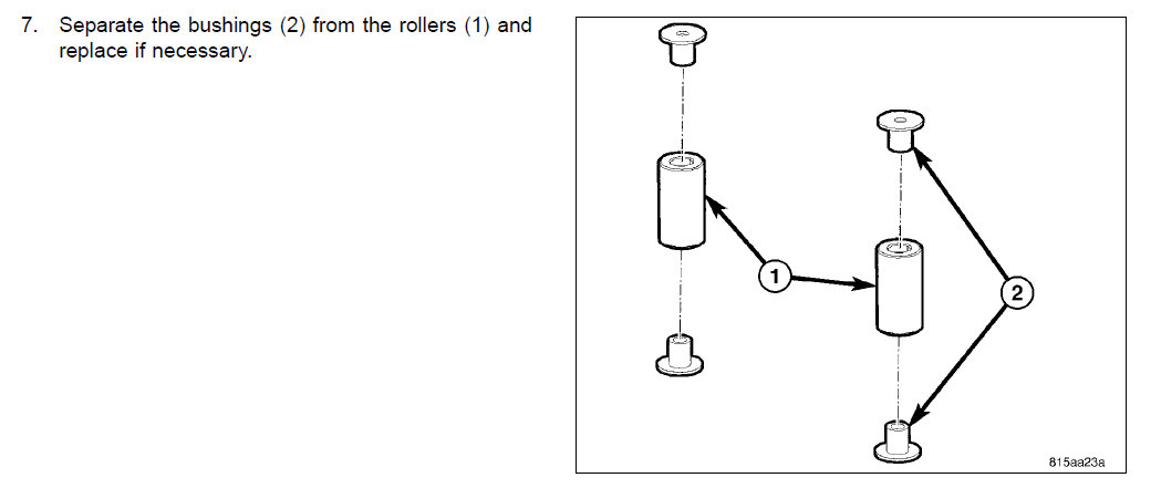

The PN for the rollers are...
5143198-AA Horizontal roller kit (requires 2 ea at $20.05 each)
5143199-AA Vertical roller kit (requires 2 ea at $6.43 each)
Shipping was $13.95
They are still available still but by special order only. They come with the pin, 2 bushings, e-clip and the roller.
My horizontal roller kits just came in today. My vertical rollers were undamaged so I didn't order any.
