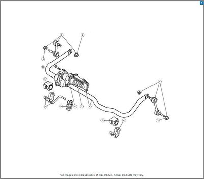

Hey NTS, that is true about our sway bar links, and many places don't understand that. However, using the link above, it takes you directly to our sway bar component listing and from our perspective, it is very clear that the part I ordered, SHOULD be correct, I mean, there just isn't anything on that page to say otherwise. It clearly states "with disconnecting sway" plus the image shows our bars and components to the tee. I will wait and see what this guy says back to me, but if he still insists I have to choose his $230 link, I will do one of four things. 1) Buy these: http://www.dtprofab.com/DTP02043-PowerW ... p_313.html. 2) Talk to Don 3) Try to find PW at salvage yard 4) Go ahead and buy what I ordered and see what arrives in the mail.

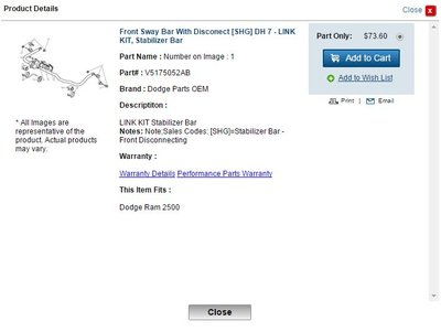

Post by jersey1880 » Wed Aug 12, 2015 10:03 am
Sorry if I led you astray Dodgeman, I never ordered anything from that site yet but it seemed legit. I did find some on a Mopar parts finder for a dealership near my house. Says they are $73.60 per link kit. I am going to call them today and see if this is for real. If they are, I can order some extras for you?

Better yet, I printed out the exploded view and the part number and am going to stop by the dealership after work to order the end links in person. I will keep you guys updated.

Re: Sway bar parts numbers
Post by jersey1880 » Thu Aug 13, 2015 10:08 am
Well, stopped by the dealership yesterday. Apparently the V5175052AB part number is for a 'value line' end link and these parts are currently not available. The guy proceeded to look up the non-value line ones and he came back with that $230 per link price (same dead end road that dodgeman found). Even with my Chrysler employee discount it ended up being $194 per link. I told the guy "no thanks" turned around and left. I am dumbfounded those things are marked up that much. Looks like I will be ordering the DTprofab end links: http://www.dtprofab.com/DTP02043-PowerW ... p_313.html

Thank you for that Jersey. I will tell this place to remove my end links from the order and refund me, but keep the bushings and send them to me. I'll go buy the ProFab ones today. I have an offroading event coming up, Wheelin for the Wounded, and I want my truck in ready shape to crawl the rocks, without being so squeaky. :)
