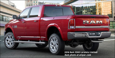

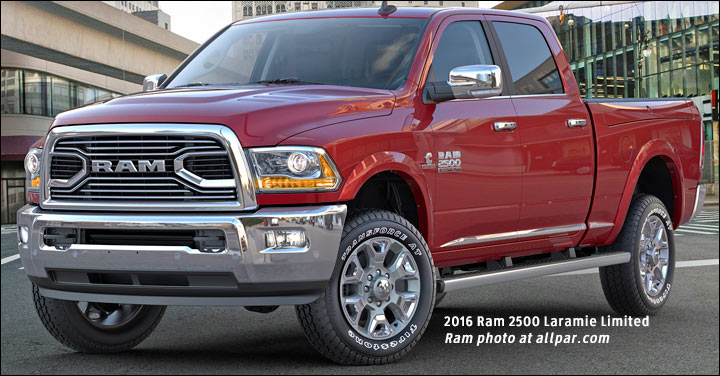

This is the grill and badging on the tailgate I was referring to, but I think it may be just the new Limited package... not necessarily a 2016 thing...

olyelr wrote:This is the grill and badging on the tailgate I was referring to, but I think it may be just the new Limited package... not necessarily a 2016 thing...
OMG , that is effin UGLY !!!
