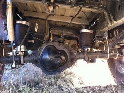

I've got the Air Lift 5000 (have an internal heavy duty bump stop as a back up if the air bag ever fails) and the Daystar cradles. So far the set up has worked great for me!

Mine don't have the metal and I have heard they can wear out with the friction between the bag and the Daystar cradle. However I can always replace just the bags if I need to.

I deflate my Air Lift bags completely when not towing or hauling. By they have the internal bumpstop.

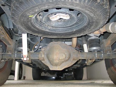

My $0.02 ...
I'm on my third pickup/camper combo and all three have/had airbags , all three were daily drivers without the camper on the truck . Airbags are a relatively inexpensive upgrade , easy to install , there when you need them and not there when you don't . They will greatly improve the handling when driving at speed , they will help , but not eliminate sway/rocking when traveling at very slow speeds , like when going over speed-bumps or driveway approaches at an angle . When the rear end of any vehicle begins to sag , the steering axle begins to lose contact with the road producing vague handling , coupled with the sway of the camper , it can get pretty scary . After you get them on , you'll wonder why you waited .
On board air is a nice addition but not necessary , after I load my camper I just set the pressure and leave it alone.
I also have Rancho 9000 adjustable rear shocks , but would probably use a custom valved non-adjustable shock if I left the camper on my truck full time. I also remove the four , 30lb. each jacks .
When you install them , wrap the air lines with flexible wire conduit for cheap extra protection , on my previous truck I used the conduit at chafe points , on the PW I covered the entire length end to end , the stuff is cheap !
As far as Carli airbags go , I have no personal experience , I'll agree that they look very well made and that they are expensive .
Right or wrong , my logic is that for CAMPERS , their inboard mounting location would provide less leverage to help with side to side sway , but would work just fine for adjusting ride attitude when carrying heavy low center of gravity loads or towing trailers .

Never realized the carlis were inboard of the shocks ! That would be less effective. Cruz how do you level your camper when camped, if you don't adj. your air pressure ? and have the jacks off ?
