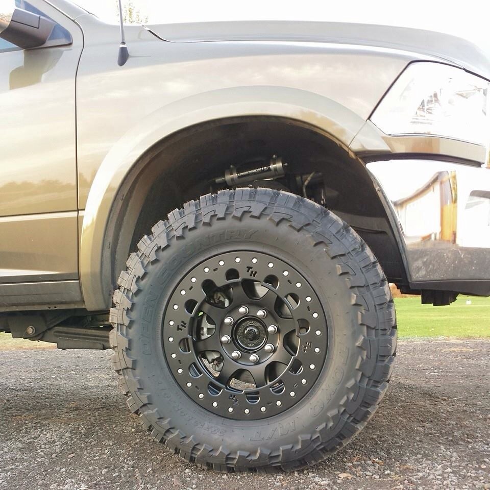

I have had numerous conversations with Don Thuren and he assures me that 37" tires will fit on the 14 and up Wagons (They are completely different from 13 on down)... The key is either using your factory wheels or getting an aftermarket wheel with backspacing as close to factory as possible... I ordered Trail Ready bead locks with 5.8" of back spacing and 9" wide... I will be running 37x12.5 Nitto Trail Grappler MT's... Only minor trimming required... Just waiting on my wheels... I heard TR has been really backed up since Easter Jeep Safari... In putting the 37's next to my current 35's it looks like they will fit not problem...

There really isn't much out for the 14 and up gas trucks, much less the Power Wagon... In fact I spoke with numerous spacer kit companies when I first began to explore my options and many of them said not to run their kit on the power wagon because of the difference in height... Carli has come out with a lift for the diesels but nothing for gas yet... AEV has their lift but say its not ready for the power wagon yet, or at least last time I checked... As stated earlier I have had four or five conversations with Don Thuren now and he feels very confident that my 37's are going to fit with minimal trimming to rear pinch seam... As soon as my wheels finally show up I will be putting 37"s on my 15 PW... Don is running his 2.5" coils on his 14 CTD and has Toyo 38x13.5x20 tires on 20x9.5 TR bead locks with just the same minor trimming to rear pinch seam... Technically his truck is only .5" higher than a stock PW in the front... He told me that if I wanted the truck to sit level then I could actually run his rear coils on my truck and it would actually bring the back down about an 1"... He did not recommend this if I towed a lot, but I do not tow a lot... The rake of the truck does not bother me so my plan is to keep the suspension the way it sits now... When Don comes out with his FOX shocks in a few months I will more than likely upgrade to those as well... If he comes out with new coils with all the proper bracketry and bump stops then I may look at that for the front...

Dude 37's on a stock wagon will look great! Awsome if it works!! I think you'll be fine dons truck runs 38's on 3" of lift with no glass so you should be good!
