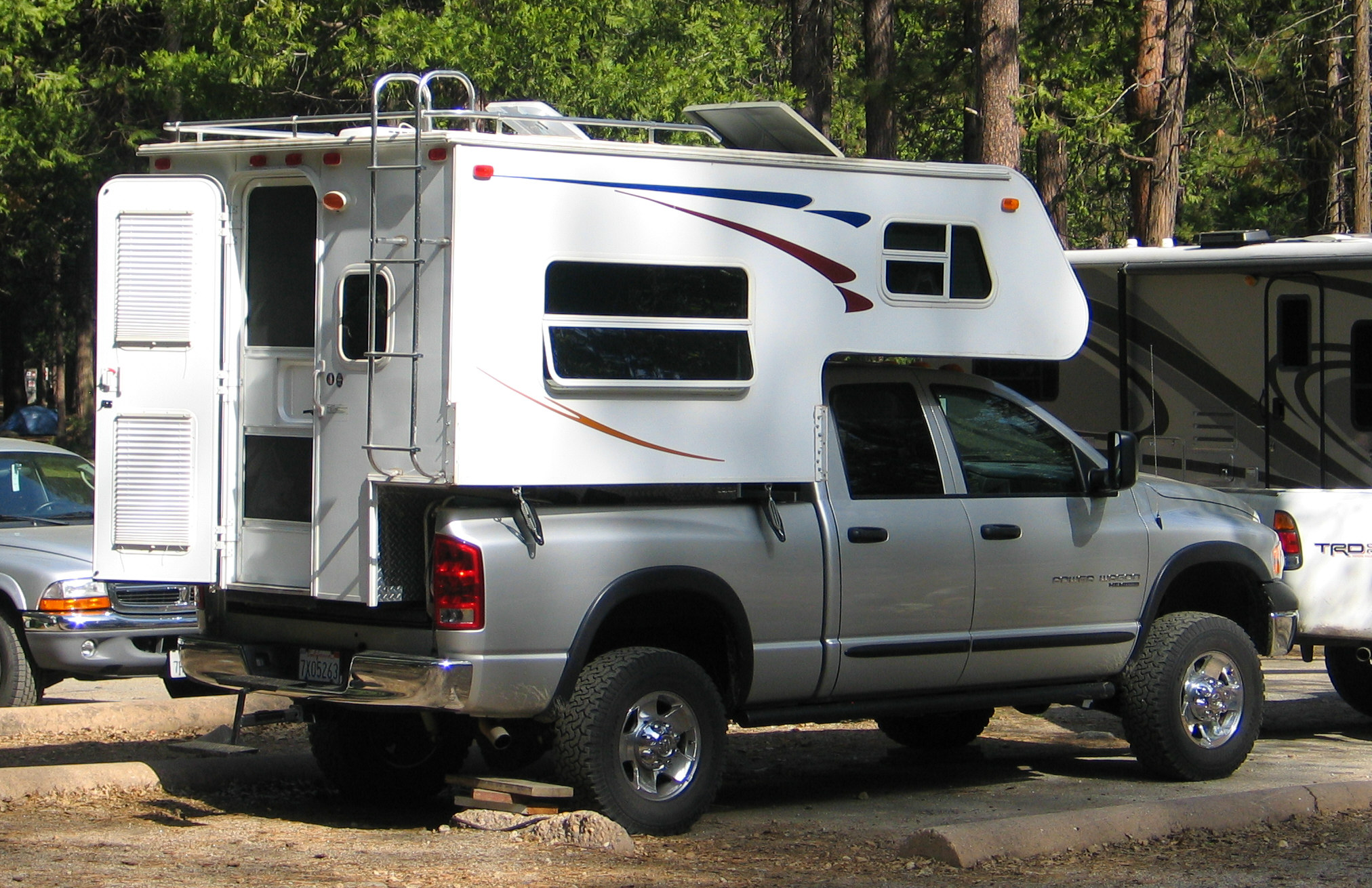

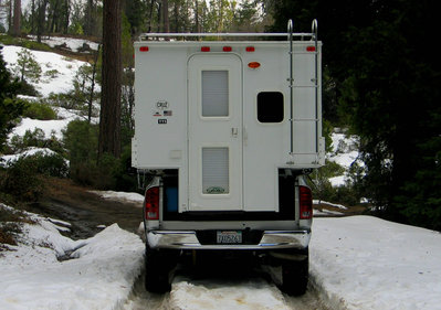

you sound just like me, as far as how to use the PW. I've had mine on every kind of F'd up trail you can think of with the camper. Only suspension mod is air bags. As they say a picture is worth a bunch of words.
- Powerwagon Nut
- Posts: 61
- Joined: Sat Apr 19, 2014 7:26 pm

I have an 2005 PW and a 1600 pound (loaded) camper. It is a 1994 Pastime, pretty light construction although it has a wood frame and plywood interior (no pressboard). I love both the truck and the camper...no mods except tork lift camper tie downs. Worth every penny.
edit: I think the leaf springs are better for normal 'truck' use and the coilovers are better for off-roading, if you are going to be hauling heavy loads, towing, and loading up a camper with food, gear, etc. I would find a truck with leaf springs.

With minor suspension mods, I see no reason why you would be disappointed with a PW. This is my third truck and camper combo, only changes to my stock '05 are air bags , adjustable Ranchos and E-rated Falkens .
Camper weighs 1200lbs. dry and on average maybe about 450lbs. of gear + provisions . It works for me .
