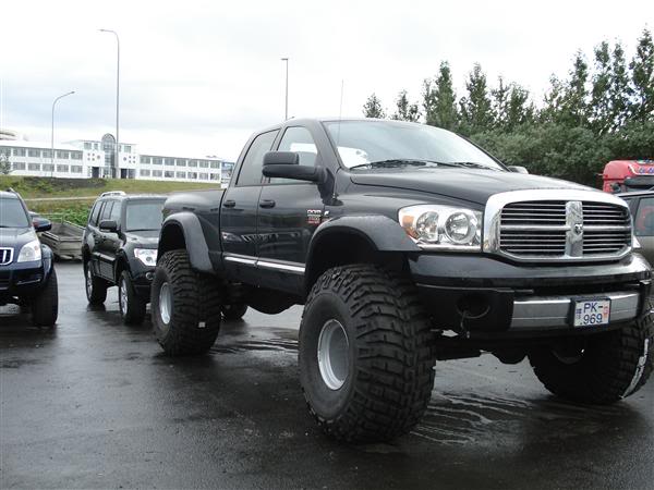

Although just throwing this out there. These guys don't use chains and seem to be ok lol. see wider is better. lol

I just want a set of these flares...2011TXPowerWagon wrote:Although just throwing this out there. These guys don't use chains and seem to be ok lol. see wider is better. lol
Re: Tire size - What's the skinny?
Mega Cab dually rear fenders and 4500/5500 factory front fenders...Mr.Smith wrote:I just want a set of these flares...2011TXPowerWagon wrote:Although just throwing this out there. These guys don't use chains and seem to be ok lol. see wider is better. lol
http://www.americanduallyfenders.com/pr ... nger-side/
http://www.cumminsforum.com/forum/4th-g ... lares.html
