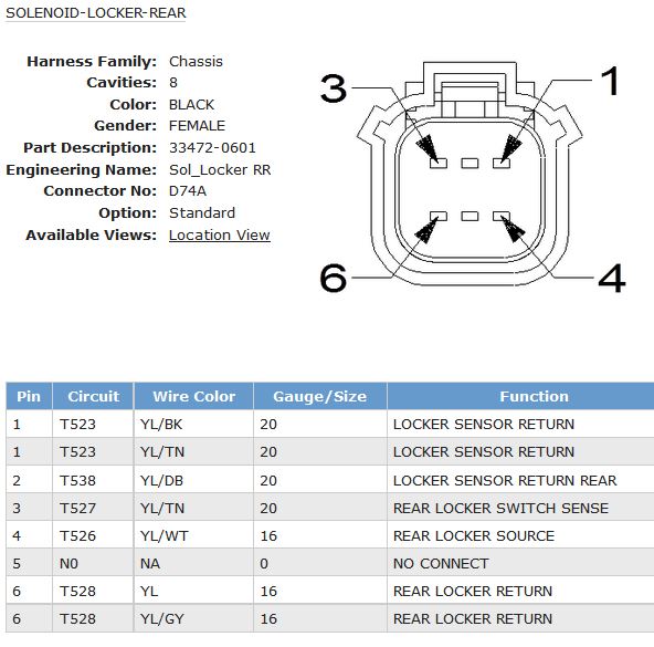

You have a 15 right? There are 4 wires on the front and 5 on the rear. The only two you need to use are for the solenoids. For the front, it's pins 1 and 4, and the rear is 4 and 6. Pos and neg don't matter...

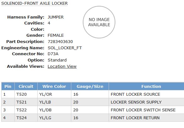

myoung84
Posts: 1475
Re: How to hardwire lockers on new gen trucks?
Post by myoung84 » Wed Jan 28, 2015 11:07 am
Here's the wiring info. Not sure why they list two wires on pin 1 and two wires on pin 6 on the rear connector. And you don't have to cut the wires, I have connectors available if you really want to hard wire yourself, even if temporary. These connectors aren't that expensive. I can send you front and rear with pre-crimped pig tails for not too much...
Post by SnakeEyes » Wed Jan 28, 2015 11:22 am
I am assuming the plug pins are # the same way front and rear since there's no pic for front?
So basically I run 12v + to the source and run locker return to ground threw the lit switch?
myoung84
Posts: 1475
Post by myoung84 » Wed Jan 28, 2015 11:28 am
No, the front is a 4 pin connector. All of the trucks up to 2013 have the same 4 pin connector at both axles. In 2014 when they switched to the 11.5 AAM axle, they changed the rear to a 6 pin and added an extra sense return for whatever reason. The pin numbers are on the connectors though. On the 4 pin, pin 1 is in the same location and pin 4 is diagonal from pin 1.
And yes, 12V to source and ground to return.
I sent you a PM too. ;)
